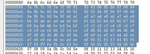

Full table dumps work too :
http://i260.photobucket.com/albums/ii15 ... Packet.png
But only if they have no escaped bytes in them...
That could be my fault, or Aaron's fault, checking...
Aaron's fault :-) Yay, I can go to bed soon :-)
