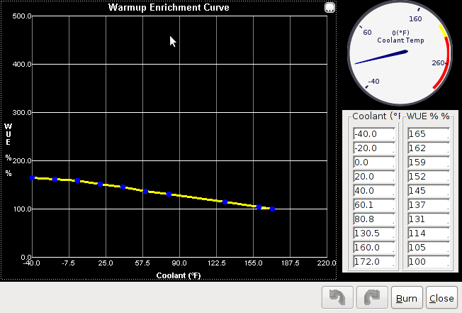

Fred,
Ok, this is mine. I **know** that this is not good for 'at load' during WUE. I have it tuned so that idle is reasonable and under load is rich. When I drive on this and ambient temps are low (near freezing), it is very rich.
IMO, 2 WUEs are needed. One for idle and one for under load.
Gearhead
