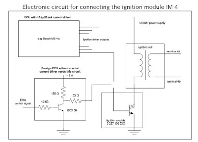

Figuring out the high current drives. So yeah, higher resistance internal resistance with IGBTs is bad for the injector response time with 12(14) volt system. Going for MOSFETs this time. The VNx14NV04 would indeed seem like the ideal choice, the TO-220 package version is VNP14NV04. The injector circuit is the same old, no reinventing the wheel there. Troubleshooting LEDs are in place too. The same circuit should be OK for the PWM task too. Would there be a future use for the in-built fault indication? It would make troubleshooting easier with code to support it..
I reconsidered the idea of having two dual-purpose transistors shared for injection/ignition. I plan on focusing on the Bosch ignition modules, and since those only draw 22mA at most, there's really not a great need for extra heat sinking. Surface mount transistors should do fine. A datasheet from Bosch had a nice reference design for 3rd party EMS design. It does seem like inverted setup compared to usual FreeEMS behaviour (MCU pin high, output to ignition module low) so it needs to be inverted twice... other than that, doesn't seem too complicated.

KW1252 wrote:
It does seem like inverted setup compared to usual FreeEMS behaviour (MSU pin high, output to ignition module low) so it needs to be inverted twice... other than that, doesn't seem too complicated.
What? That's not true. The vast majority of ignition drivers require a high input to dwell. This is the FreeEMS default behaviour, and is in hardware, not software.
Use FET-drivers for ignition outputs, and keep the voltage supply to them configurable in hardware, too.

how can the mcu pin be high and the output be low if the signal is inverted twice?
Am i missing something or wouldn't you only need one inversion?
To invert something twice is the same as not inverting the signal at all isn't it?
Tue Dec 03, 2013 3:45 am
Joined: Tue Jan 15, 2008 5:31 pm
Posts: 166
Yeah, I got a little confused there for a minute. Of course the system isn't inverted; I guess I'm not at my sharpest at midnight anymore.
Anyway, the actual transistor for the ignition module driver is going to be a FET and not some odd throughhole BJT. The provided schematic was a nice gesture from Bosch, it eliminates a bit of guessing.
Any thoughts about the malfunction detection, worth the effort and board estate?
