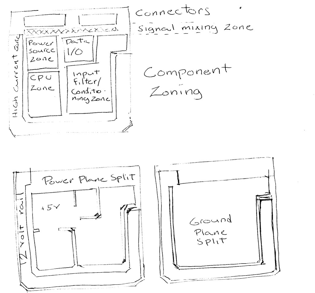

Hardware layout
You don't design the board before doing the schematics, but the two do go somewhat hand in hand, and here's my take on the PCB layout. Top layer is for the really sensitive signals and most components, and is zoned for each function group; CPU is at the signal hub. The second layer is the ground plane which is split at the 12v area, the third layer is the power plane which is split into star-ish power distribution pattern. The bottom layer is for control signals, filter circuits and decoupling capacitors. Between the header and component zones is an area where signals from top and bottom layer are distributed over all four layers to help with routing the header.
I'll start the schematic design with the IGBT drives. I want to use one design for all high current outputs, and the IGBT needs to be pretty hefty. International Rectifier has a nice logic level IGBT capable of handling 125w and 20amps, I think it'll suffice. It's part number is IRGB14C40LPBF; here's the product page from digikey:

Gnarly sketch of the PCB layout, Q&D department in action!

Interesting enclosure. . . . Reminds me of something. . .
What software package will you be using?
Also, you are correct, my experience with that enclosure is that the tabs do break if you open up the case often.
Nice ideas though. Code doesn't support your inj/ign configuration yet and I think you should include vr as the circuit for it doesn't consume that much PCB real estate.
You also need to address how map hoses etc are going to be fitted, unless you are going to support external map only.

I think a good place to start would be to define what the goals of your project are, ie: what type of injectors you are wanting to support (low impedance or high impedance), what type of ignition systems you want to support, etc instead of stating right from the start what I/O configurations (ie: IGBT for injectors and Ignition outputs).
I would advise you to look at the Ravage https://github.com/dvisser/Ravage and Jaguar https://github.com/DeuceEFI/Jaguar projects as both schematics have many of the circuits you propose already layed out and tested on running engines. If you look at the Jaguar repository make sure you are in the "dev" branch as it has the latest improvements based on feedback from many FreeEMS testers.
Take a look at what the Jaguar PCB currently supports viewtopic.php?f=67&t=2212. This thread also lists the current limitations of the freeems-vanilla firmware.
ST Microelectronics has a nice line of logic level driven MOSFET low side drivers that range from 6A to 20A, I used the VND7NV04 6A D-PAK version on the Jaguar, but you could use the 12A D-PAK version since it is the same package size. The larger rated 20A version is a larger D2-PAK package. These are in the VND series of SMD MOSFETs. I'm just curious why you want to have outputs rated for 20A?
Just let me know if you have any questions about what has been done on the Jaguar schematics.
Re: Karri's "Wildcat" EMS for ModICE enclosure
IGBTs are not appropriate for injectors, at all.

The Cinch ME enclosure is easily opened with hand tools (popsicle sticks ...), but has the same rugged construction. It is unfortunately much smaller and is limited to 48 pins. I am in the process of building a MicroSquirt Module-based prototype for a fellow, and it's a nice little box.
There IS a 'blank' header / faceplate available, to allow other connection options.
Remind me - Is there CAN communications for this design yet? You might consider running all the sensors (except cam and crank), plus some of the aux outputs to one box, with the primary box having the main processor with the cam and crank, spark and injection IO.
No CAN yet and that sounds like a horrible idea for most key sensors. OK for auxiliary stuff, though.

Which sensors change too fast for CAN? TPS, MAP, ...?
Another point to ponder with the ME is it has more useable headroom than the LE or SE, perhaps allowing stacked boards.

Ah, so there was to summary of the available features. And as I thought, I have a couple of feature ideas without firmware support (yet?).
The blank faceplate option was explored, turns out for all of the options headers (that I found) overlapped with the PCB holders on the faceplate, so that didn't turn out a solution to the pin problem.
I forgot the link for the enclosure from the start post (or it might've gotten lost during the edits, I edited it a lot.). Here's the manufacturer page:
http://www.cinch.com/products/modular-i ... -enclosure
The enclosure sets a number of limits. First, beside many other things, it's great at capturing heat too. I've selected a version which has heat sinks for twelve TO220 components. SMC transistors are fine where there's no significant current to be expected (like signal lights), but more high-current prone stuff will likely have use for the heat sinks. There are no provisions for tubing in the enclosure, so internal pressure sensors are not possible without compromising protection rating, which largely voids one of the key benefit.
Injectors will be high impedance. I wanted to do low-z earlier, but since Bosch introduced their EV series they've lost a lot of their older glory, and so I instead opted for a simpler circuit. Igniters are to be external too. Neither actually need the huge current rating, but it's there for ruggedness. About IGBT's not being appropriate for injectors, I'd like a bit more than an assertion on that. They're used in many solenoid-based devices, what makes them unsuitable to drive injectors?
The reasons I don't plan to include the VR sensors is because I also want to have a VSS, even though there's no support for it in the code (yet anyway). VSS sensors are normally either Hall or optic, since VR has problems tracking very low rotation speeds. Thus, I would need to include a separate buffer circuit for that sensor anyway; keeping the selection in just Hall or Optic, just one chip can handle all the channels, while adding a VR conditioning chip would increase individual part count (while I'm pretty sure this device will never be produced by pick and place machines, I'm developing it as if it was), create more tracks to route and use up two pins in the already crowded header. However an external unit would be quite possible.
