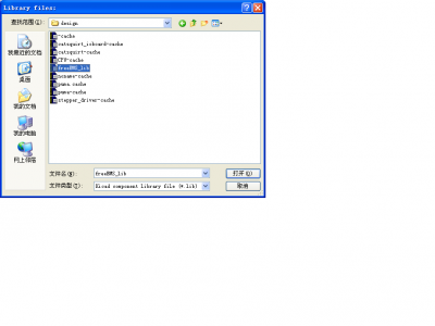

It also appears that some of the libraries that you used don't exist on my PC since they show up as boxes with ?? in them when I look at this schematic, but could be that I don't have your library loaded.
