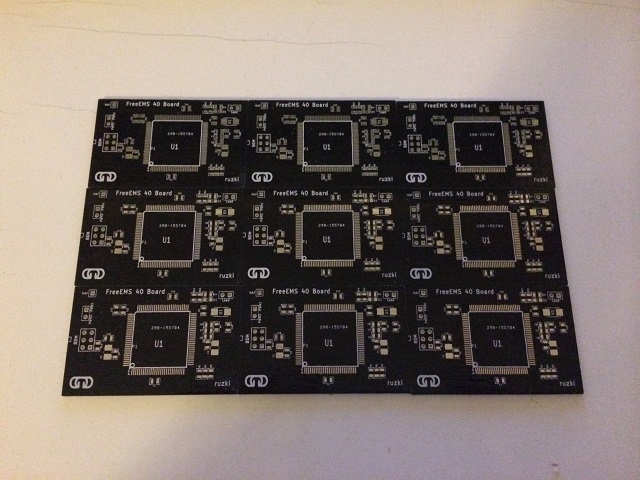

Re: FreeEMS Board ruzki
Today i added a license and a readme file.
Made some small changes to the PCB, see commit ..
I ordered 10 Board´s today as i now made a license btw. Thank´s to DeuceEFI !!
When they arrive i will open a thread in the sell´s corner.
Georg.
Georg.

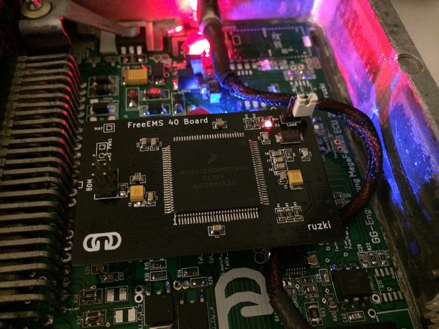

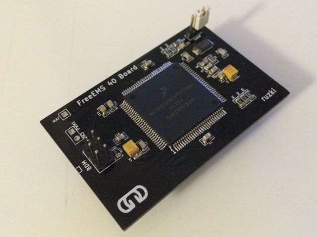

New Boards !!
Now with working load jumper and LED.
9 of them will be now up for sale.
