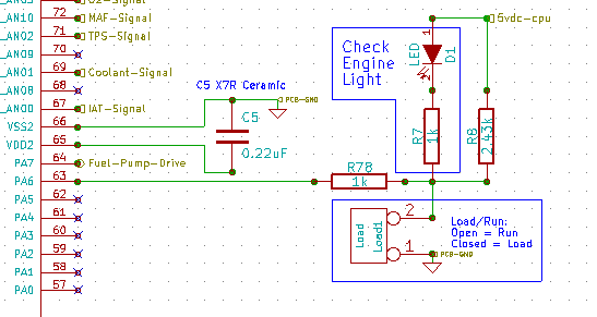

You need to add the LOAD circuit back to Port A6 or else you won't be able to load firmware. At a minimum you need a 1k ohm resistor between Port A6 and the LOAD jumper and a 2.4k ohm resistor from the LOAD jumper to Vcc. The LOAD jumper is used by jumpering it to ground to boot the microprocessor into the serial monitor mode so that the loader software on your PC can work.ruzki wrote:tooly suggested a additional pin for MAF so here ist v0.2b
This board will be sent for production tomorrow... if nobody has concerns
See my attachment for the circuit.
Re: FreeEMS Board ruzki
This is exactly why you should pay attention to reference design schematics such as jaguar and ravage.
You leave out critical stuff like the load jumper circuit and you are on your own and in for a world of frustration and dirty hardware hacks.

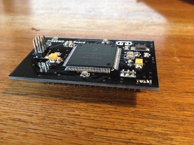

Quick Update !
Board is running.
I have tested ADC´s, Injectors and fuel pump with 0.2.0-SNAPSHOT from DEUCE.
For test purpose have inserted and removed the Board about 50 times. It feels pretty rigid and solid.
I didn't buy the special bended connector, just took the standard ones and bended them..
Thanks everyone who gave me constructive Feedback

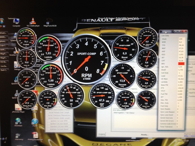

Yes BRV is wrong ..
