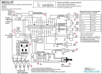

Схема включения блока SECU-3T(пример) для одновременного или попарно-параллельного впрыска. Высокоомные форсунки, шаговый РХХ.
http://secu-3.org/wordpress/wp-content/ ... epper1.png

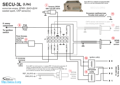

Примеры включения блока SECU-3 Lite
SECU-3 Lite wiring diagram. Hall sensor and distributor are used
SECU-3 Lite wiring diagram. CKP sensor and wasted spark are used

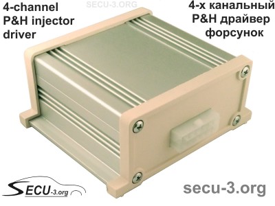

4-х канальный P&H драйвер низкоомных форсунок
Raw PCB
Raw PCB

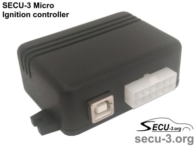

SECU-3 Micro ignition controller unit.
http://secu-3.org/forum/viewtopic.php?f=10&t=838

Sorry for posting in English... but:
1) what style of signal does the P&H box take as inputs?
2) what is the pin utilisation, 3 ground, 1 12v, 8 obvious?
3) are your match boxes the same size as the Swedish ones we get here?
4) what diagramming tool do you use?
Cheers! :-)
Posts: 2420
Re: Аппаратная часть (Hardware)
Post by STC »
Hi Fred,
1) Any type of output (TTL, High-side, low-side, open collector). Optional pull-up and pull-down resistors are provided...
2) 3 pin for ground, 1 pin for +12V supply, 4 inputs, 4 outputs
3) Part number of corresponding box is UNI-S-BOX-070 http://www.kosmodrom.com.ua/pdf/UNI-S-BOX.pdf
4) Old version of PCAD

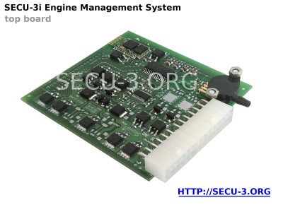

Several photos of the new EMS unit - SECU-3i
Assembled SECU-3i unit
SECU-3i top PCB
SECU-3i top PCB

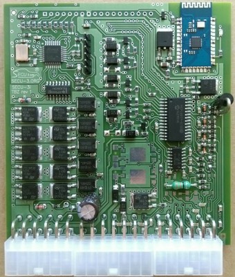

Top board of SECU-3i with an embedded 5-channel peak and hold injector driver. This board is on testing now. PCB has 4 layers, SMD 0805 and 1206 components are used.
Bottom side
Bottom side
Top side
Top side

Очень хорошо! Safe to say that’s a third-party Bluetooth adapter on the top right?
