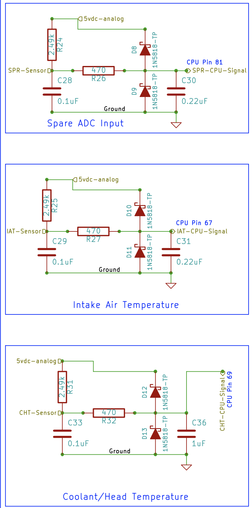

All Bosch sensors; so thermistor bias resistors R25 and R31 are 2.43k metal film resistors.
Do I use R24?
Do I use R24?
- Posts: 578
Re: walinsky's jaguar 0.7 #28
R24 is only populated if you are using a thermistor on the Spare ADC input, otherwise you can leave it empty.
