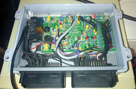

Now I have dived in Ubuntu world. First own firmware compiled and big thanks for that goes Mr. Onion! He has helped a lot and told secrets for Ubuntu.
Some progress on Jag enclosure also. Finishing goes later, when I get my bug in garage from rain. I'll start new topic of ride.
