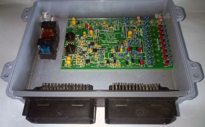

Here is my plan to add splash water sealed enclosure with 56-pin connector. Few fuses and relays are in box also.

You appear to be defeating the purpose of a relay?
Don't forget to bridge your grounds appropriately, too.

Re: JaniM's "watersealing" Jaguar 0.7
Relays are for main and FP and fuses for injectors, FP and some general supply like for lambda controller.
Idea is to do more plug and play. Less wiring job.
Groundings would be checked closely.

Re: JaniM's "watersealed" Jaguar 0.7
Just be aware of the voltage spikes and interference that relays can cause. Ensure that you use diodes directly on the relays, and not at some distance along their wires.
Also, the point of them is to reduce the length of heavy wire to a minimum, ie, point to point with lighter control wires from source signal to relay also point to point.
Yes, diodes are in adding list.
Some progress. Now need only add injectors and ignition wires.
