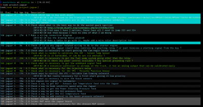

I started to lay out a task list.
-  Full task list
They are sorted by urgency, grey ones are block, blues need to be done to unblock them (some blue ones are also blocked by others, I still did made a theme for that).
To narrow them down to a first milestone I tagged them:
Updates comming soon.

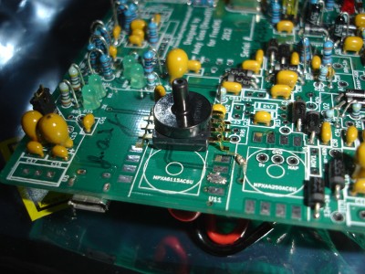

				Hello, so I got both, I want to go with with MPXA6115ACU first, cause its a direct fit and I don't plan to go away from the 7psi (stock boost) in the first few months, also, having to do the same thing twice allows me to better understand what I am doing.
Because I am very dumb, and a noob. so bear with me.
-  Map place
What is the orientation I should solder the MAP, reading the
datasheet tells me nothing (or I can't read nothing into it, figure out what's Ground, 5v and output to figure out an orientation.
What are the Injectors|N and Injectors |P(B with vertical line on top of it)?  I shall only connect the GND and the output that next to eah LED right (i am sure its that, just making sure)
Shall I pass all the grounds trough a common connection before the connectioning them to the board like most of the OEM ecus i rip off junkyards have? I think this makes sense.

				Thanks to malcom2074 i found the Power, ground and variable output on page 4, did not kow how could i've missed it.
				Re: Masterkorp's Jaguar 0.4 alpha build.
				Posted: Mon Mar 17, 2014 1:12 am
				by DeuceEFI
				masterkorp, see this thread for MAP and AAP trace corrections before soldering on the on-board MAP or AAP sensors:
viewtopic.php?p=34891#p34891
The "U?" designations denote where pin #1 is on each IC on the Jaguar boards.
