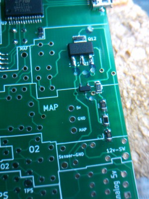

First step was to drill some random holes on the traces.
-  Traces cut for Q12 mods

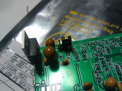

Then build cpu power supply. I could not get the right size tants at this stage. I might eventually replace them.
-  cpu power
Tests OK at exactly 5.00V on my fluke.

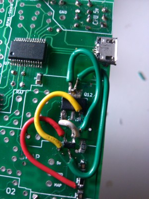

then it was some patches for the Q12 mods. Untested at this stage. If it looks wrong tell me now!
-  patches

Highly recommend replacing the regulators with bent legged regulators. Sad, as your current one seems very accurate, and it's a shame to waste them. Thing is, if/when you mount this up, those leads are on borrowed time without strain relief. You can wing it and repair as necessary, but it will fail eventually, likely sooner than later, without a strain relief.
I have no idea if the clamp fix is OK or not, but you can carefully test it by attempting to raise the voltage gradually and ensure it stops at 5.15 or whatever it's supposed to be, and stop at ~5.6 or so if you don't get that result, to avoid damage. Use resistors to a higher voltage to achieve this, start with higher ohms, lower step by step.

Here's the analog PS. If you look carefully you can see some traces cut in preparation for the smd map sensors.
I'm now stuck because the analog regulator is getting too hot and I can't see why. I can see it will always flow a little current even when no sensors are being powered but not enough to make it hot. I am using 2940's instead of 2937's.
