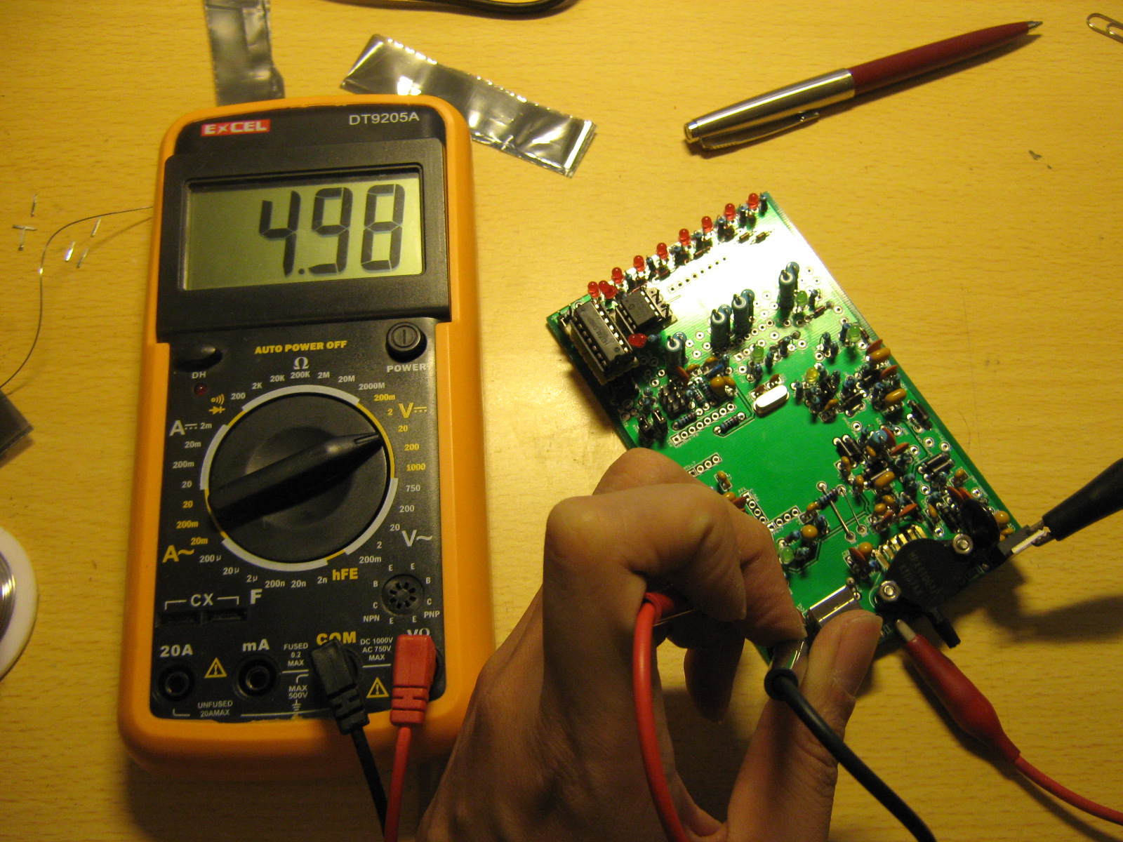

Today, I have the MPX4100 flipped and fixed.
soldered jumper wires between p20 & p21.
tested power 5v outputs.
checked FDTI chip talked with Debian & Mac.
