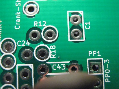

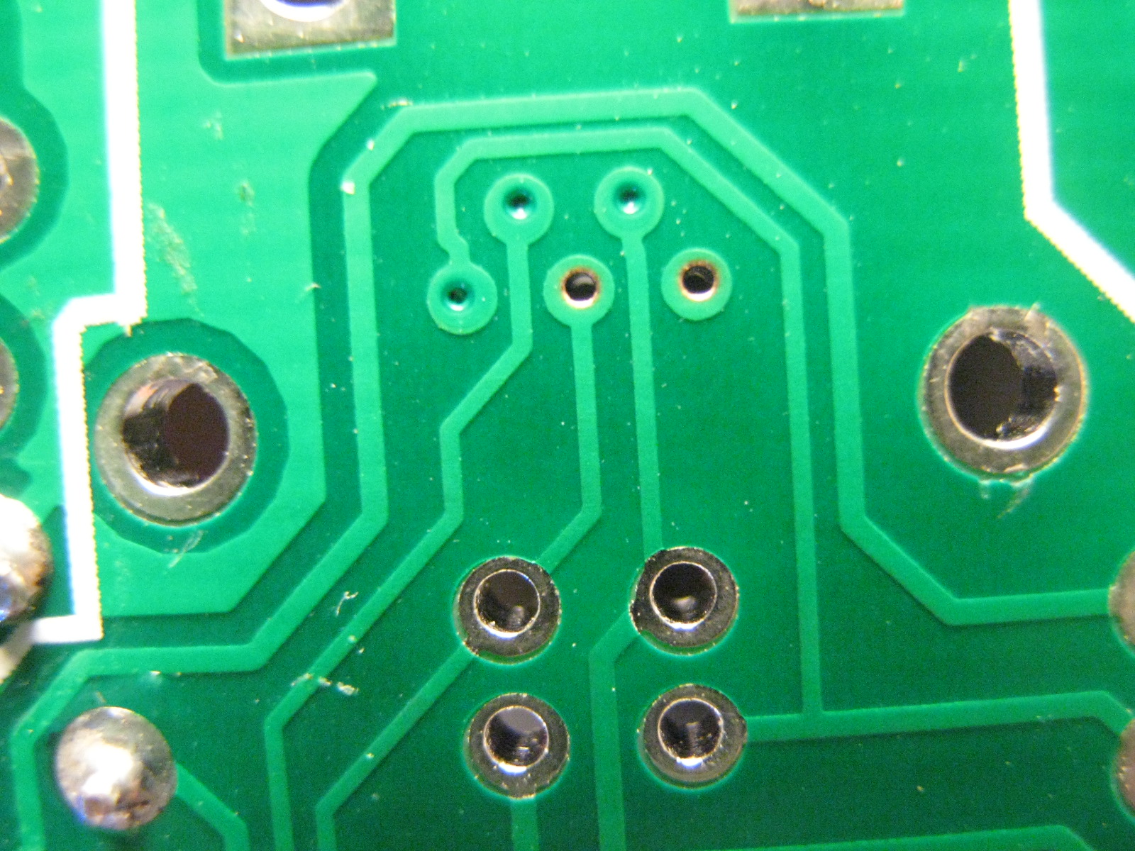

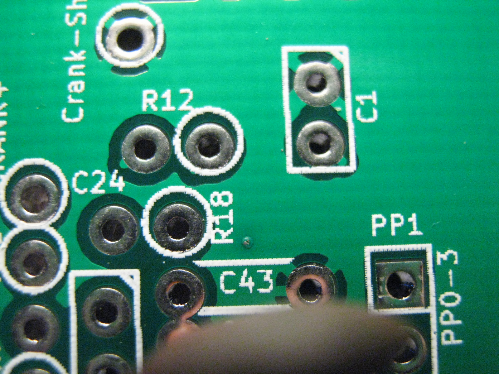

I am using USB-B socket. so the mini-usb trace fault will not affect. Besides, my PCB vendor did very bad on the Mini-USB area. Solder mask covered all pads & holes
I have checked the trace of R12 & c1 on my pcbs already.. my boards are alright.

LOL @ soldermask issues. Care to post a close up photo for lols? :-)
Good news on c1/r12.

Thanks! :-)
Maybe you should cut that trace anyway, just in case someone in the future tries to put a mini on it :-)

done...
I have removed the solder mask as well LOL

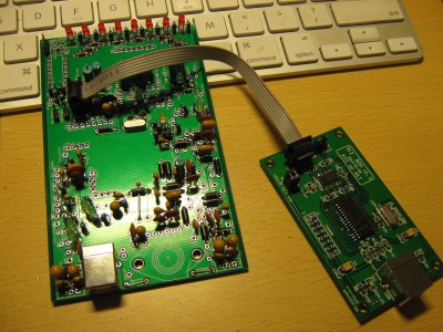

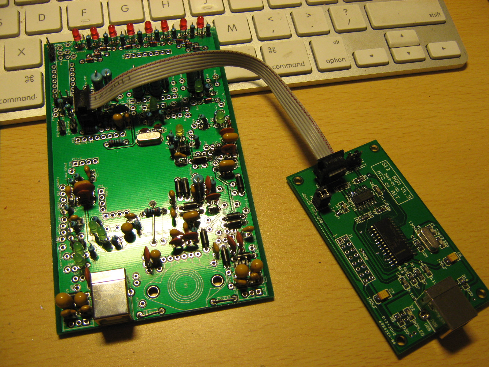

More soldering done... WIP slowly...

Re: KennyBug's Jaguar board build

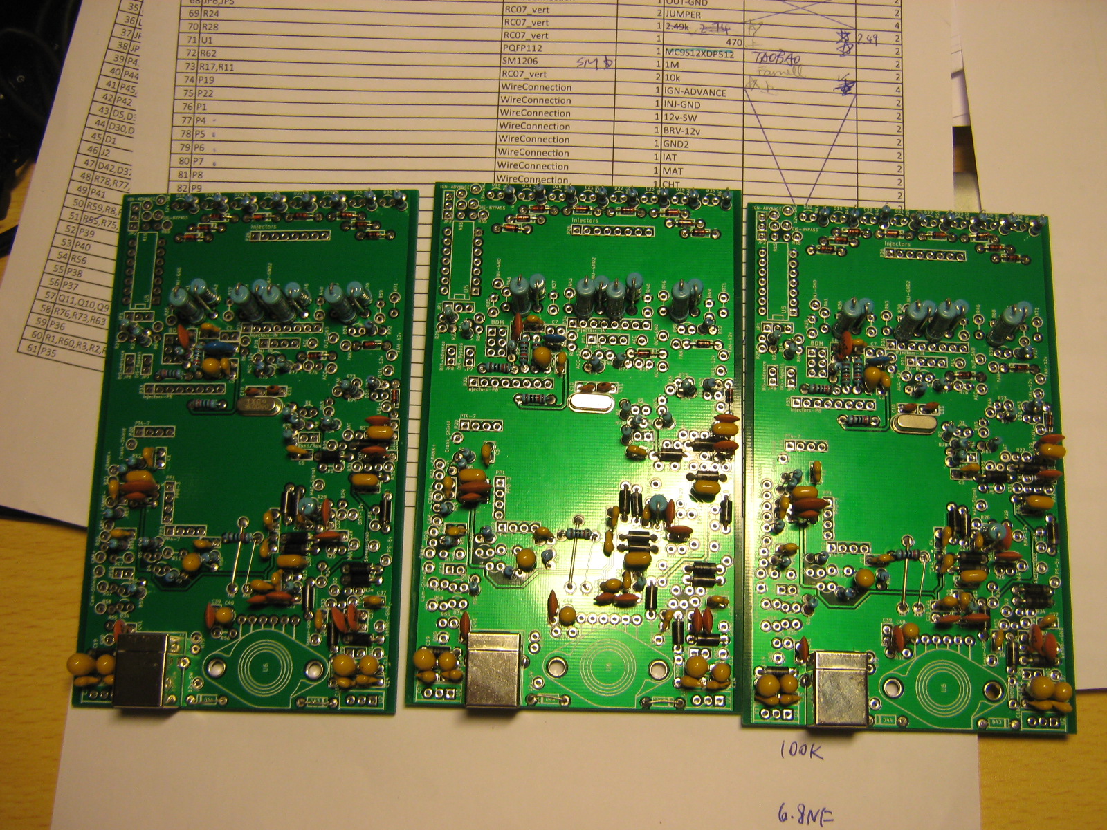

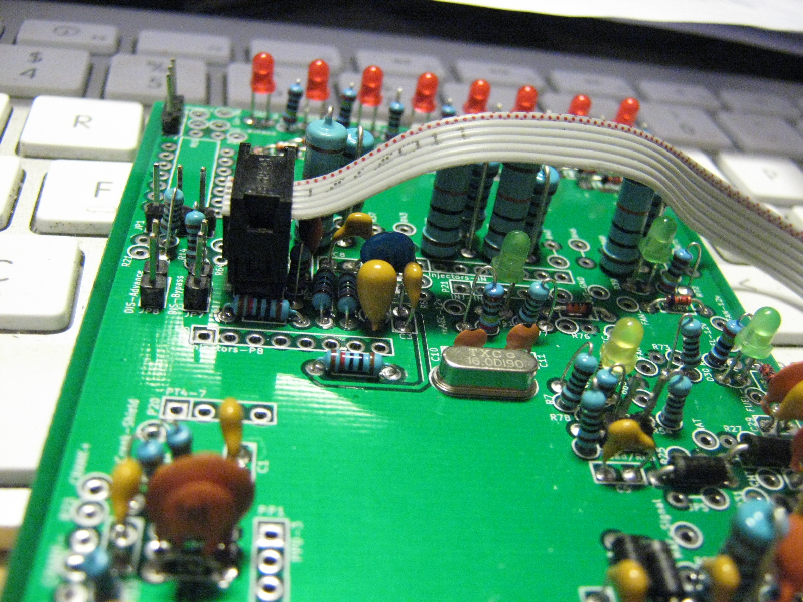

passive components almost done.
Cool :-) The 2 leds on the vr out are experimental, use higher than specced R values till testing complete, maybe 5k?
I am so mindless that wrongly ordered 100 pcs of 470k (instead of 470R in BOM), that's why some R are missing.
Okay, will replace R9 & R10 by 5.1k.
