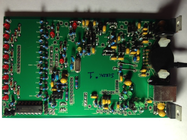

I have completed the assembly of my Jaguar A3 board Serial #1 per the Jaguar Assembly Manual found in my github.com repository, which will be updated with step by step photos later on today.
Attached to this post is a photo of the Through Hole side of the board.

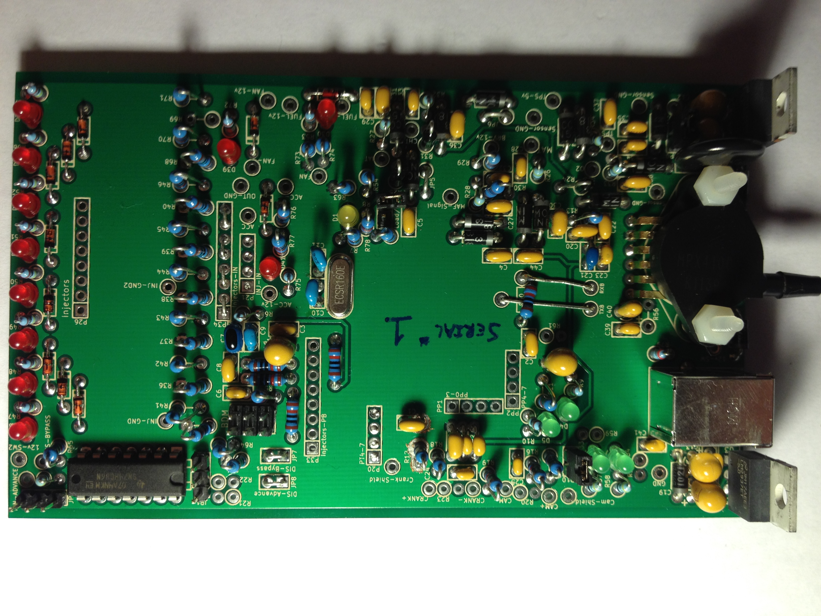

- Posts: 579
Re: Building Jaguar A3 board Serial #1
Higher resolution of the same image from before...

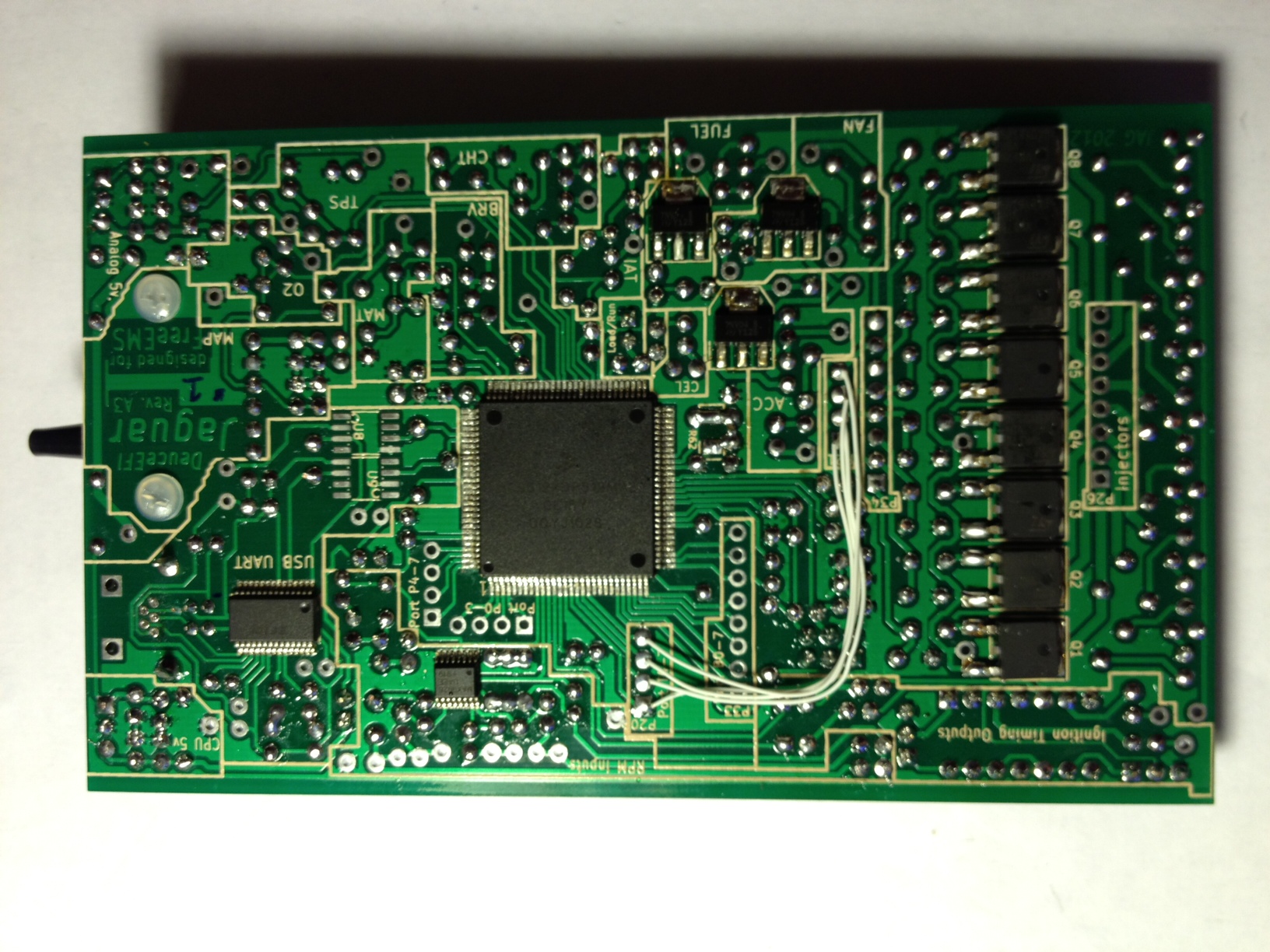

Other side (SMD side) of the Jaguar A3 board.
