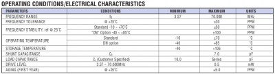

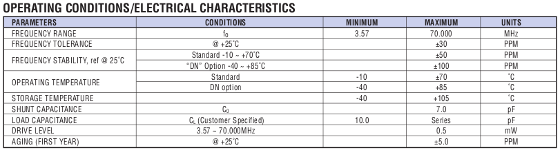

I have changed the BOM and the schematic to use the 20pF load capacitor as per the manufacturer's specification after rethinking my choice of the 18pF load capacitor after Dan's recommendation. I have the same crystal installed on a prototype board with the same 112pin Freescale CPU with 22pF load capacitors and it works fine, so I see no reason to go down to 18pF, so 20pF it is.TonyS wrote:Hopefully a better description of my concern -DeuceEFI wrote:TonyS wrote:6. BOM calls out a crystal with 20pF load capacitors, but schematic and BOM indicate 18pF caps are being used (not sure of the impact).Hence the 18pF caps instead of 22pF...Dan wrote:You will probably find that you cant get a nice 16MHz crystal that requires 22pF load caps. 18pF/12pF is probably a better choice for crystal availability.
The mfg's specifications for the crystal that is on the BOM, specifies 20pF load capacitors (which in my opinion is what should be used). The load capacitors may / will be different for other 16MHz crystals depending on the mfg, mounting type, series,... I really don't see a good reason to use anything other than what the mfg's spec for this specific crystal says to use.
