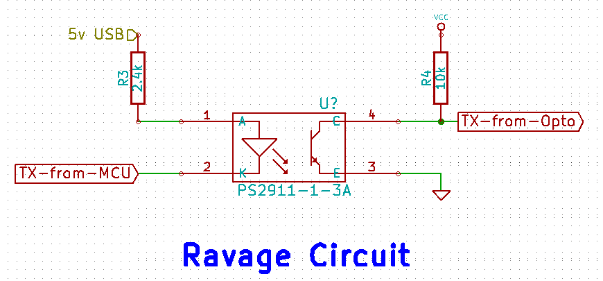

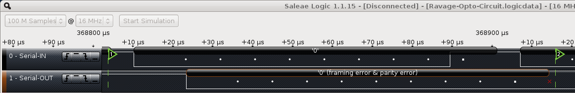

I originally placed the optos on the PCB and ran them thru the reflow cycle and installed the resistors exactly like the Ravage schematic. In this configuration all I saw as output to cutecom was 0x00 repeating forever.
I have only been testing with the TX from the MCU as the streams out data at a good clip to cutecom or MTX. Originally I had the RX opto installed, but I was unable to flash the firmware with it installed so I removed it to verify it would work without the optos in the circuit. At this point the RX is directly connected from the MCU to the FT232RL chip.
I originally tested the circuit exactly as drawn in Ravage, even using optos that had not gone thru the reflow soldering process on my solder less breadboard (I soldered them to a 0.100" 4 pin header strip), but when I saw it was not working I tried lower value resistors in steps down to 220ohms. At that point I began testing with the test circuit that was in the data sheet and at least it did not invert the data as the Ravage circuit had done, but even with the best combination of resistance values that I tested it still corrupted the data stream.

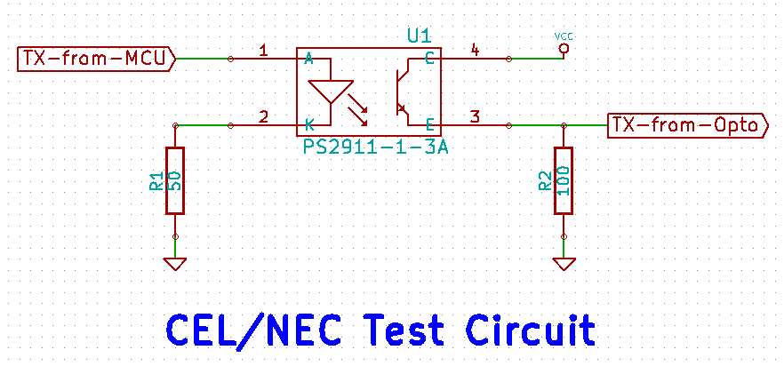

OK, I have a correction to make, the Ravage opto circuit did NOT "invert" the data, it just didn't work in that configuration as seen by my LA trace. Sorry for the confusion, when I first looked at the data it appeared to be "inverted" until I investigated further... Lowering the resistance values of the pull up resistors did not improve the way the circuit functioned.

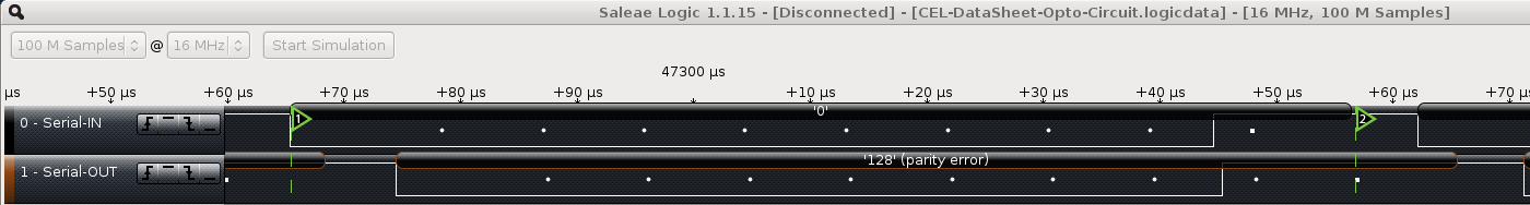

Once I switched over to the CEL/NEC test circuit configuration without the pull up resistors the output from the opto showed data, but the data was incorrect since the opto was unable to switch from ON to OFF as quickly as it could switch from OFF to ON.

Here are the circuit configurations that I used for my testing...
- Ravage opto circuit
- (8.04 KiB) Not downloaded yet
- CEL-NEC Test circuit
- (7.22 KiB) Not downloaded yet

Andy, all you did was change the default state, which would prevent the engine from running without the FTDI powered up. All other changes that you saw were from resistor value or current capacity in the CPU varying from push to pull. Make sure you leave the circuit as in RavAGE or it will not work.

Note that the FTDI Input Switching Threshold spec is ~ 1.2V. I don't know if you can change the LA threshold to match, but it might provide some insight as to when the FTDI RXD pin "sees" valid highs and lows.

Hey Fred, I just want to make sure that I understand what is needed -Fred wrote:Andy, all you did was change the default state, which would prevent the engine from running without the FTDI powered up.
The default state / no data going into the RX pin of the uC should be a steady logic high -yes?

Standard baud is 115200, though the firmware would be happy going much faster, no one will need it really.
Default state without any current through the opto should be logic high on the CPU RX pin. Yes! :-)
