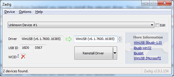

See the attached image.
If you run Zadig (found at C:\Program Files (x86)\pgo\USBDM 4.9.5\USBDM_Drivers\zadig in 64bit windows), find your device, which is typically Unknown Device, then click Install Driver for WinUSB, it will work on 64bit Windows.
Make sure to select WinUSB in the selection box, and the BDM in the device selection dropdown. YOU CAN SCREW UP YOUR SYSTEM DOING THIS, so be quite careful to select the USBDM.

Thanks Malcom and Pishta,
I opened Zadig just to have a look but didn't do anything with it yet just in case the driver is already installed and I screw it up.
When I plug the BDM in now, the indicator light on it lights up, so I'm assuming that the drivers are installed. Also, if I go to Device Manager I believe it shows up as "libusb (Win USB) devices" > "USBDM interface". manufacturer pgo. "this device is working properly".
If this is the case, what is the next step to load the serial monitor S-19?
