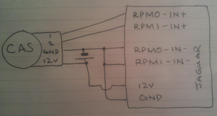

For Hall Effect timing the schematic diagram says to connect RPM0-IN- and RPM1-IN- to ground, but the board doesn't have the -IN- and -OUT- suffixes. Is this right?:
Board | Diagram
RPM0+ = RPM0-IN-
RPM0- = RPM0-OUT-
RPM1+ = RPM1-IN-
RPM1- = RPM1-OUT-
Am I right to assume that the RPMn-Shield holes are for the shield wires around the signal wires?

Each RPM input is a differential pair with +ve and -ve inputs. The outputs go direct to the CPU. When you setup each input, the whole set of components for that input must match for it to work correctly.

Fred wrote:Each RPM input is a differential pair with +ve and -ve inputs. The outputs go direct to the CPU. When you setup each input, the whole set of components for that input must match for it to work correctly.
so..... the earth.... from the CAS
…. is joined....
to RPM0-, RPM1-, and a regular ground for the 12V?
Re: Jaguar 0.6-alpha Assembly Guide
With hall/opto inputs, you need to provide the zero crossing. You do this by setting -ve to 2.5V grounding the -ve input achieves this because you have a 1k limit resistor there, and another 1k to 5V installed. then the pull up on the +ve input holds it to 5v and your CAS pulls it down to ground sometimes. When it goes up or down it passes the 2.5V -ve pin. Make sense?
I think I get the logic but I can't get from that to being certain of how to wire it, which makes me think that I actually don't get the logic.
As long as the pcb is setup right, that's correct.
