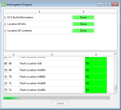

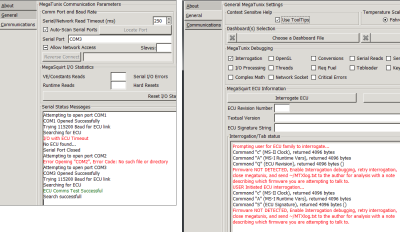

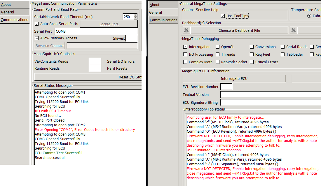

I've lost my way a bit. Spent hours screwing around with git and various linux versions hoping some combination would work. I tried getting megatunix and Freeems-loader to load the benchtest file, the mtxloader on linux says that it's writing everything ok. Then megatunix says there's no firmware. EMStudio on windows worked before I tried flashing the file, and still works. Do the boards supplied with the SMD components just have the serial monitor programme loaded or do they have the bench test firmware loaded? I don't know if the loader incorrectly confirms that it added the firmware or whether megatunix just can't read it. I definitely had some dependency issues a couple of times so I don't know what to trust.
(11.05 KiB) Not downloaded yet
