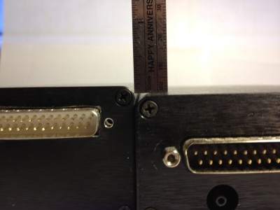

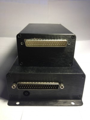

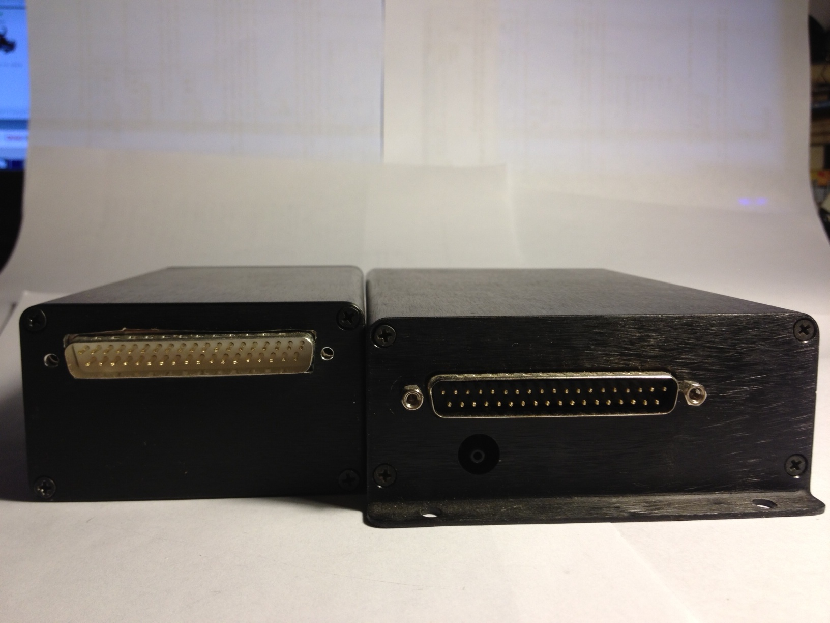

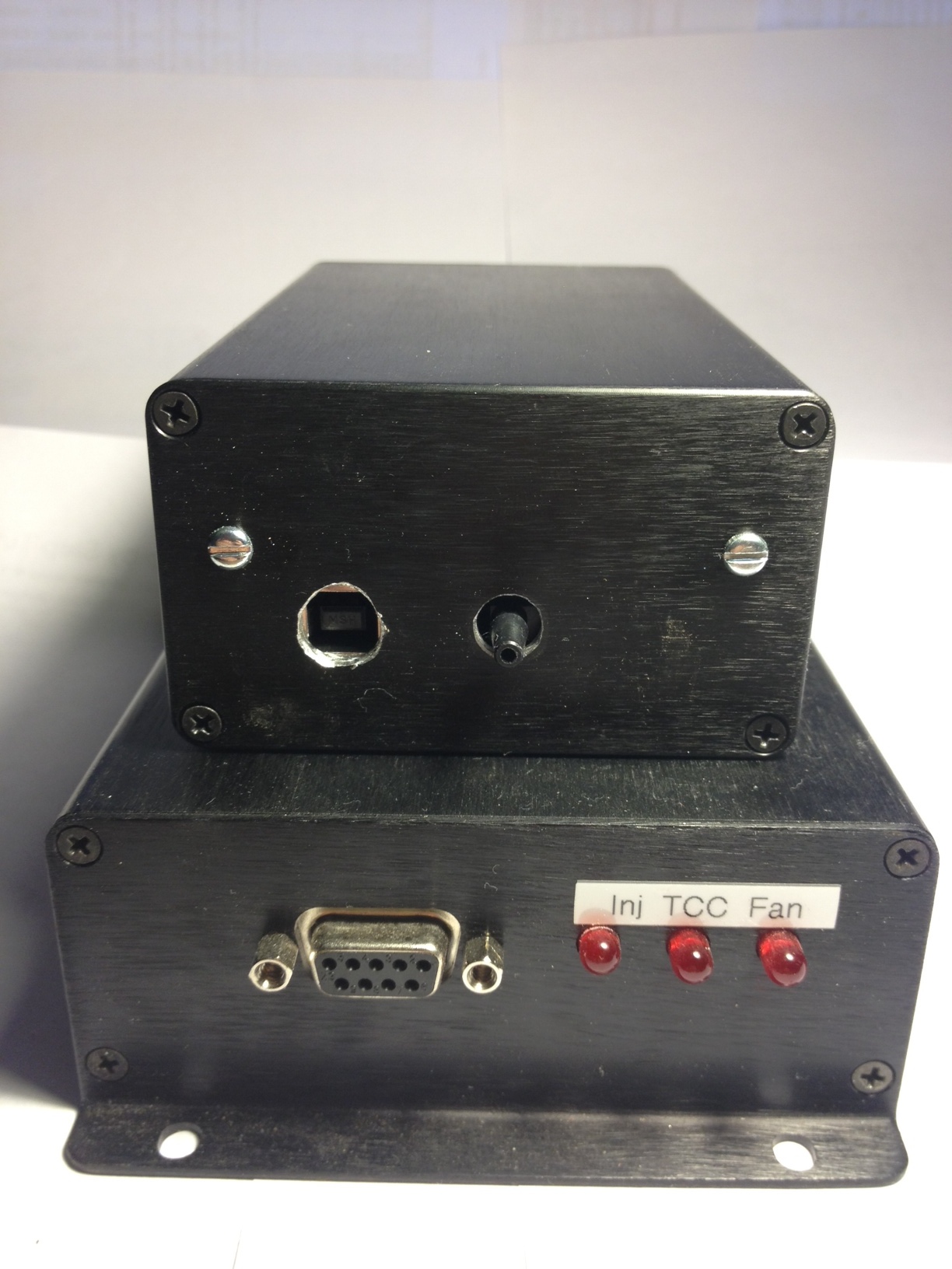

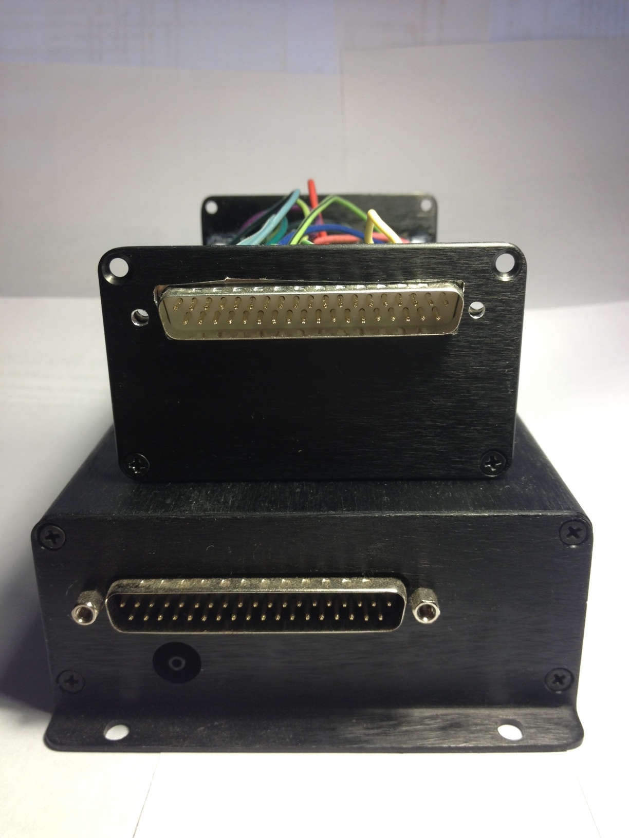

Photos with better lighting showing a Jaguar A3 on top of a MSpoo
Re: Building Jaguar A3 board Serial #1

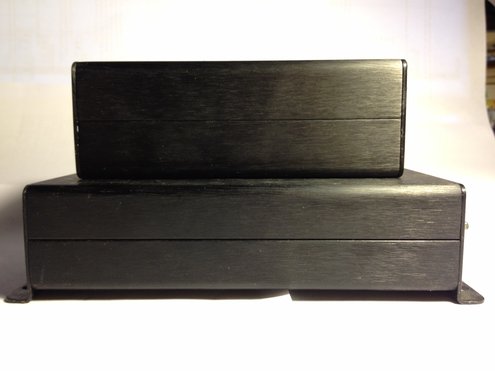

And from the side? :-) Greedy bastard I am I am.
Is the Jag a bit taller or is it an illusion?
The Jaguar case is just 3/32" taller than the MSpoo case. More photos are included in this post
That gives it just enough room to use a larger TE Connectivity automotive grade connector instead of the DB37 for those that want a different connector.
And yes, TE Connectivity (AMP) offers free samples
Different colors have different key ways so make sure you order a male and a female connector of the same color.
Look in my github.com repository in the /docs directory for the BOM to see what samples I ordered.
