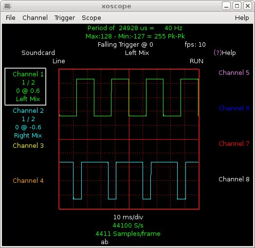

Fred wrote:It sounds like you're saying that the EST output is a normal ignition output and that, like normal, a spark is fired at the end of the pulse. The only difference being that the DIS module distributes this signal to the correct coil. If only the trailing edge matters, why do you say shorter/longer, why not fixed and timed?
The EST output pulse is based on the TACH input pulse as the standard for 10 degrees BTDC, ie: if we mimic the TACH input as the EST output the DIS coil packs would fire each plug in turn at 10 degrees BTDC. You may be correct in saying fixed and timed.
Fred wrote:I'm not saying it's the best approach, I'm just pointing out a hole in the information thus far. Does the beginning of the pulse determine which cylinder to send it to, and if so, when are the tolerances for "correct" for that. If not, then what?
The DIS module takes care of the firing order, we just need to vary the EST output square-wave to change the amount of advance.
Right, but, what if we start our pulse a bunch earlier or a bunch later, and still end it in the correct place, what happens? There must be a tolerance, how tight is it? If it's not tight, yep, the code is there. If it's tight, we might need something special.

Fred wrote:Right, but, what if we start our pulse a bunch earlier or a bunch later, and still end it in the correct place, what happens? There must be a tolerance, how tight is it? If it's not tight, yep, the code is there. If it's tight, we might need something special.
From my testing on the Deuce's engine with the MS-2 running the show, it appears that the EST (Ignition Advance) pulse starts after the TACH input and all that matters where the EST pulse ends that determines when the coil fires. And it looks like from the waveforms that I have attached to this post along with in the "docs" directory in my repository, that the EST always rises after the TACH signal and when the EST signal falls the DIS module fires the correct coil pack. So I think we will be OK with code you have already written from your quote above. :-) I don't think I need anything special, but have a look at the waveform PNG file and let me know. (Channel1 - green trace - is the 3x TACH signal from the DIS Module, Channel2- blue trace - is the EST signal from the MS-2 to the DIS module to fire the coil pack at the the proper amount of advance based on the Spark table.)
Fred wrote:The bypass thing is as easy as pie, it can be our first bit of GPIO code, I look forward to writing it! :-)
Cool :-), we just need the DIS-Bypass output to be LOW (0vdc) during 0-300 RPM and HI (5vdc) at any RPM greater than 300 RPM. This tells the DIS module to use it's base timing of 10 degrees BTDC to start the engine, then after it has begun the firing order to turn Ignition Advance over to the CPU. It sounds straight forward, but here again, I'm no programmer, but I'm willing to learn :-)
Green trace is TACH, Blue trace is EST
