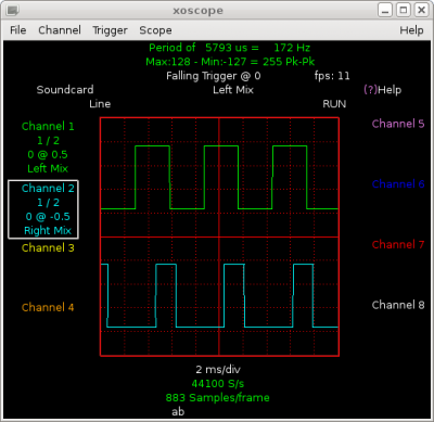

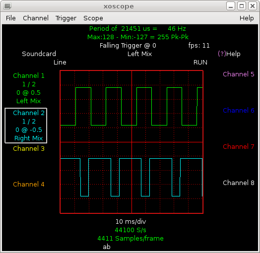

Ok, here is on look at idle and one at 3400 RPM, When I revved the engine, the EST tracked the TACH signal (with the advance added of course).
Green trace is TACH signal, Blue trace is EST signal.
They are also in my repository in the docs directory.
