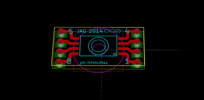

I have found out that Freescale discontinued the SOP-8 400kPa pressure sensors, they only manufacture this sensor in the SSOP-8 (smaller package). Since the Jaguar 0.4-alpha through the 0.7-alpha PCBs only have the SOP-8 pads I have designed an adapter board.
This board will solder in place of the SOP-8 sensor and allow you to solder the SSOP-8 sensor on top of the adapter board.
I have posted the design in my github repository at https://github.com/DeuceEFI/MAP-Adapter
I have included KiCAD 3D renderings of both sides of the adapter board:
Top SSOP-8 side:
Bottom SOP-8 side:
