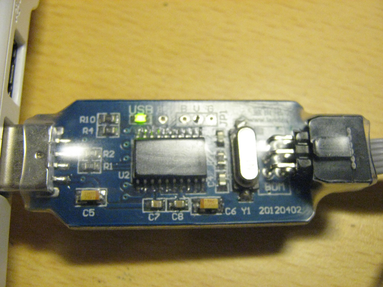

my China USBDM
can sync the MCU very fast and unsecure seamlessly
way better than old TBDML

Hi Kennybug
What is the part number of the micro that is used on the USBDM? I would like to know if I can update the software on it.

I was going to do that. But at that price and if it is the same thing it might be easier to just buy one.
