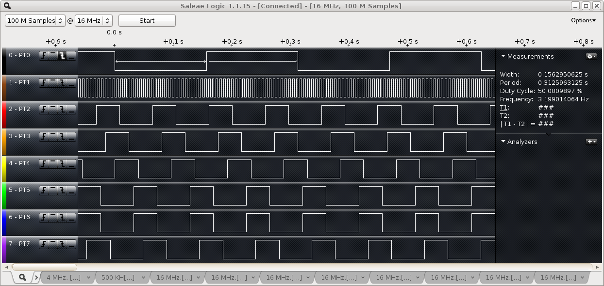

Cool, I have attached a pic showing the benchtest firmware running with the Cam and Crank inputs from my JimStim.

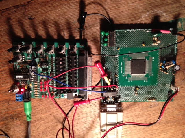

Cool, I have a test board I tested my reflow oven with that I am using right now for my prototype of the circuits for the Jaguar board. I will however get the CPU, optos and the ft232rl reflowed to test the comms.
Currently my prototype board is working with MTX and with Sean's loader
