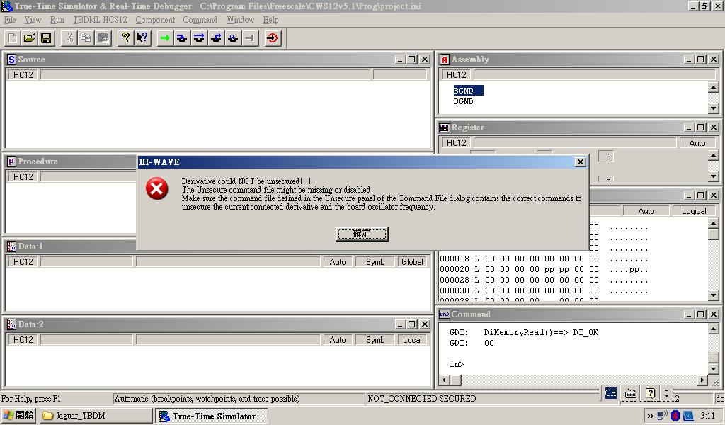

TBDML hooked up.
P&E startup is alright.
But the P&E unsecure cmd just not work.
I have tried several osc speed.
only 40MHz talks for my board.
My TBDML had a 12MHz osc.
12 and 16 does not work at all. any clue?

here is part of the log.
Very funny that the log said the unsecure cmd correctly executed.
but the window pop out said the bit was secured.

Re: Need Help on UnSecure MCU
Andy,
basically, i had followed you procedure from the pdf file.
hiwave works and the P&E cmd are running.
but it just pop out an error message as my screen capture.
a few questions:
1. what speed you are using in hiwave?
2. do your have the "not connect secured"on the status bar?
3. do i need to put the load/run jumper closed?
It's likely my MCU not sync the bus speed with the TBDML.
I have to manual set the speed, otherwise the MCU not found.
I guess the capactor c10, c11 values do matter.
i may need other capacitance for my TXC crystal
another thought, may be my TBDML firmware cannot use CWv5.1, will downgrade to V4.7 and retry tonight.
Fred,
TXC is the brand of the crystal i use, I bought them from element14.
I am now using 22pf per Andy's BOM. however, the crystal suggested 18pf.
The load capacitance is definately wrong on my board. osc amplitude may be too weak.
I think that is the reason why sometime Hiwave set cannot find MCU.
My TBDML labeled it is v1.3, and hiwave regonized it had v0.9?? firmware.
While i bought this toy, The seller emailed a link for download the CW4.7.
So i will try CW4.7 1st.
I may going ahead to buy latest version USBDM from china.
