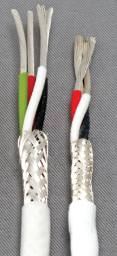

Hello Fred, just another customer in the waiting!
I also wanted to know if you recommend trying to add your board to the MS v3.57 SMB for better performance?
I've read and followed your websites install advice, although it's for the built in MS and MS3 daughter cards VR conditioners, by running a Extruded FEP Jacket Over Shielded PTFE 18 gauge 3 core wire for my 7M-GTE CPS (24+1 for cam & crank signals)
http://www.awcwire.com/part.aspx?partname=SFJ-18/3 - Basically mimicking what Toyota used back in the 80's. I'll be installing next week and hope to eliminate sync loss at various RPM points. I was currently running the shielded 2 core wire DIY-AT sells with their kits and I wasn't impressed when comparing to the stock Toyota wires. My 3rd wire was a HD video cable that worked great and that lead to believe I needed a better wire for my trigger signal input. So long story short, I'm not looking to buy a MS3-pro but rather better understand and find a better solution for my motor and application as many 7M-GTE Supra enthusiast are waiting for my findings.
Any advise would be great!
I using the wire on the right, 3 cores.

Yes, if any were available, it'd be a good addition to any MS setup that currently doesn't have a MAX992X device built in.
Good luck with your goals. I'll try to get BrickRPM available again ASAP, though ASAP may not be very S, unfortunately.
