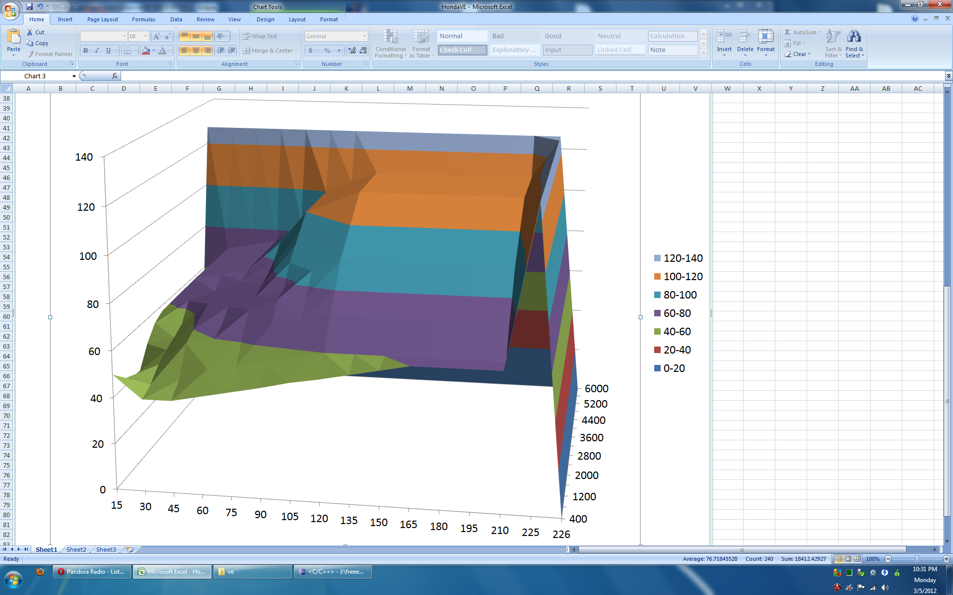

My first try at the VE table has maybe 10-15 points, and a lot of smoothing between the points. Far from complete, but better than the flat60%. RPM on the right, MAP in kPa on the bottom, and VE up the left side. I've only got up to 3200 RPM, and about 120kPa, because everything above that isn't very stable. Right now I'm planning on flattening it off at about 100% VE for the higher pressures, and then make some flat steps down to around 60% for the higher RPMs and lower pressures.
EDIT: On the LosesSync log the only sensors that are hooked up are the BRV and the MAP. The MAP isn't correct, but it's close.

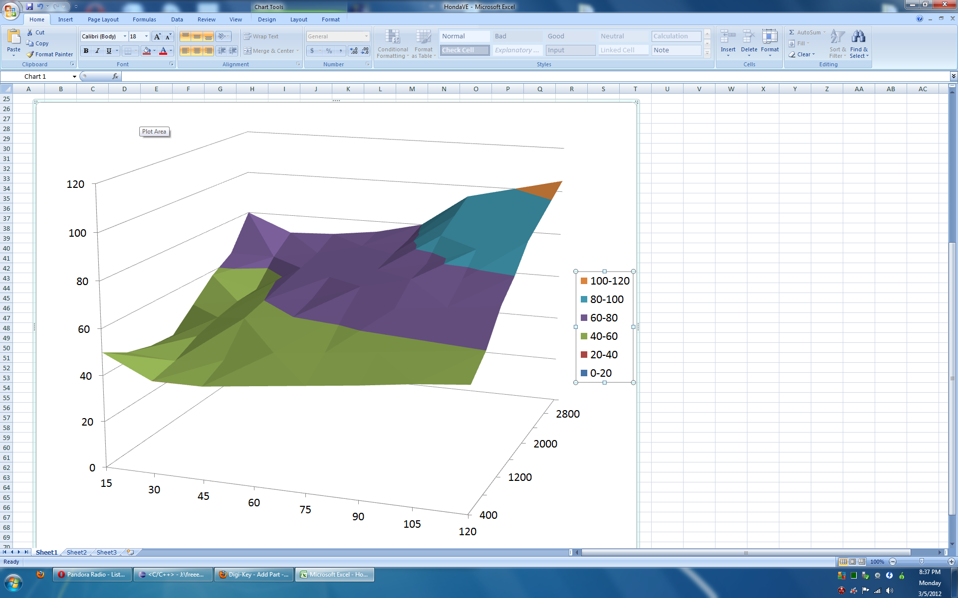

I stepped it a little differently than I was planning, but I think it'll be alright. RPM on the right, MAP in kPa on the bottom, and VE% going up the left side.

VE map looks like it's starting to take shape. Did you test it on the vehicle? Get your table back to me so it can be included in the build once you're happy that it's an improvement.
