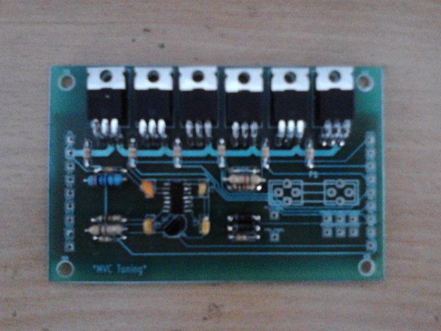

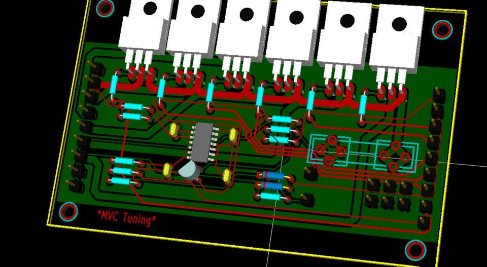

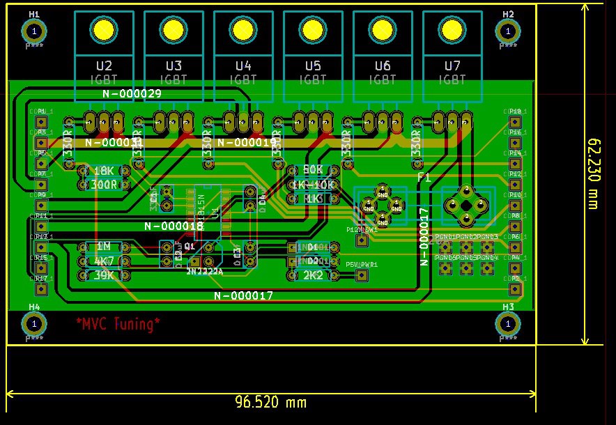

a few pictures with the IGBT module, up to 6 cylinder wasted COP, has the VR sensor input circuit based on LM1815(in case it is needed), this was the first revision, it needs larger traces from IGBTs to the COPs, and other fuse socket.

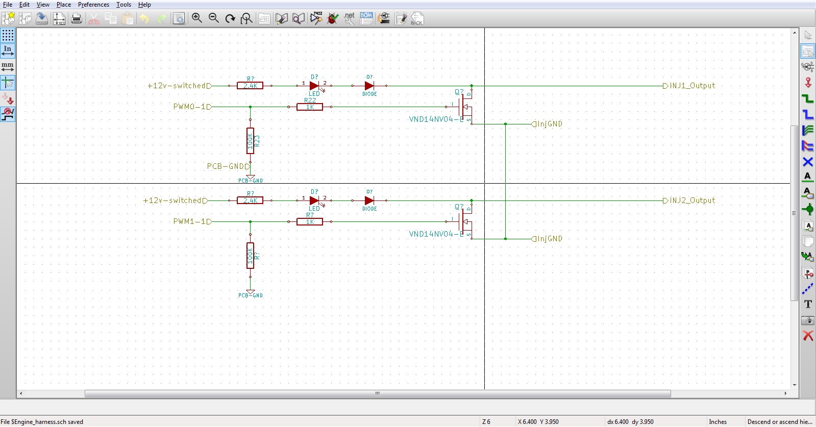

Looking on the schematics of Jaguar injector drivers, I've used only two, I just need batch fire only (sequential injection is more like stress to me and only for emissions, rally cars don't care about emissions :D ) for simplicity and quick debug.
Now from the schematics, I see 12v rail to Led then to Zenner and straight to injector, common injector ground, and between +12v rail and ground is the omnifet, PWM0-1 activates the omnifet, so based on this schematic +12v of the injector will need to go straight to the mainboard plug, and grounds at engine bloc or head, this is uncommon here in europe, all the ECUs i've seen have a +12v rail from a relay to injectors (fused), and grounds of the injectors come from injector drivers from the ECU.

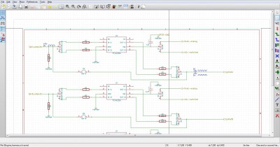

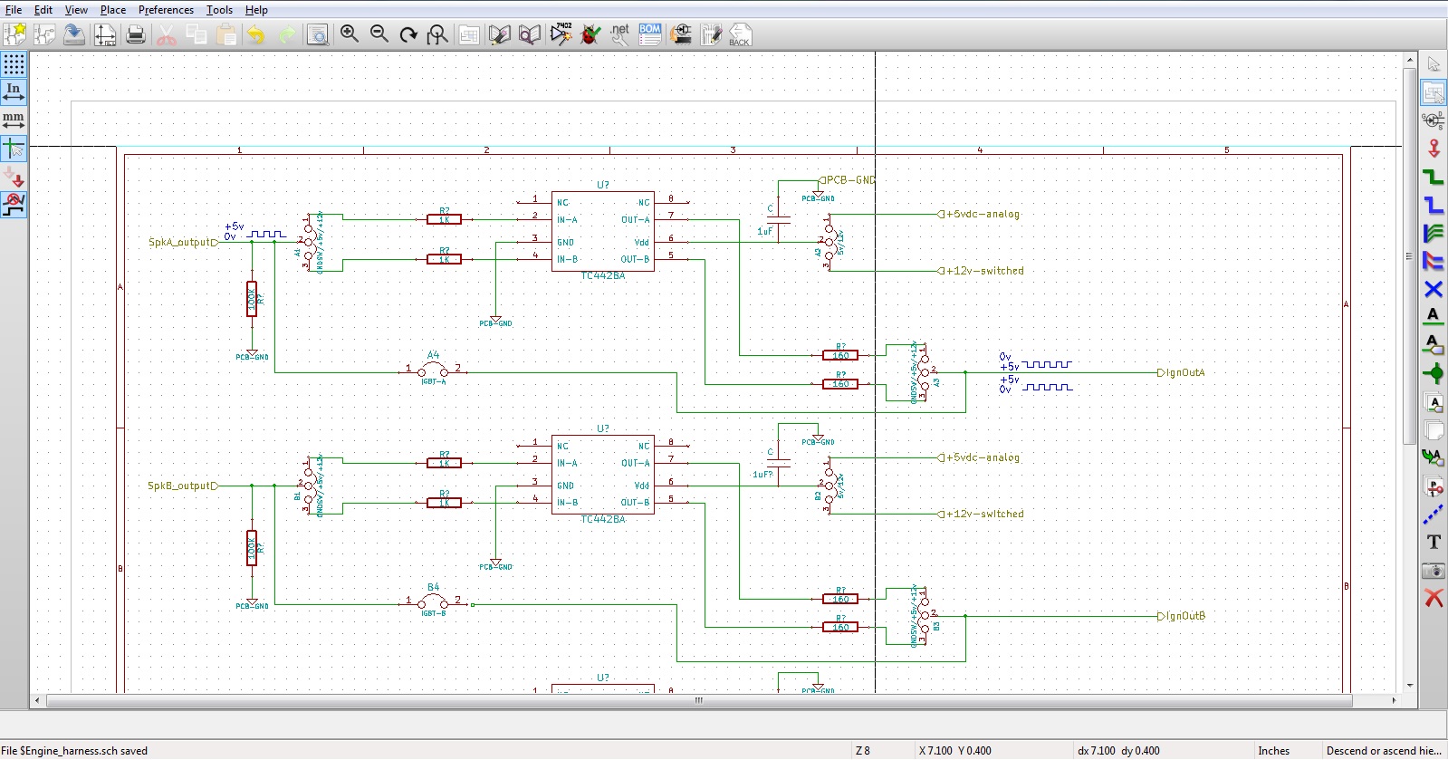

and the ignition driver schematics modified based on Fred's suggestions :D
Re: uROEFI
Ummm, no, that's not how it works. Not on almost any cars at all. Maybe none.
Maybe this will help:

Re: uROEFI
Post by m3ltd0wn »
well, I can tell you for sure that on my stoc vw ecu, +12v rail was split for each injector, and the 4 ground wires from the ecu (gray red, gray blue, gray and gray green) were wired to the ground side of the injectors ... on bmw 325 ecu was the same thing, 6 ground wires fom ecu were wired to ground of the injectors, and +12v feed was from the relay box.
i would like to keep the same configuration to uROEFI because I'm planning on making it plug and play or at least keep the stoc ecu connector and wire from there the rest of the loom.
edit:
ok, I think i got it now, was confused at first about the schematic, so INJ-out is the signal for the injectors (GND switching), injgnd is the separate ground for the high current omnifet, and +12v rail there is just to lit the led ...

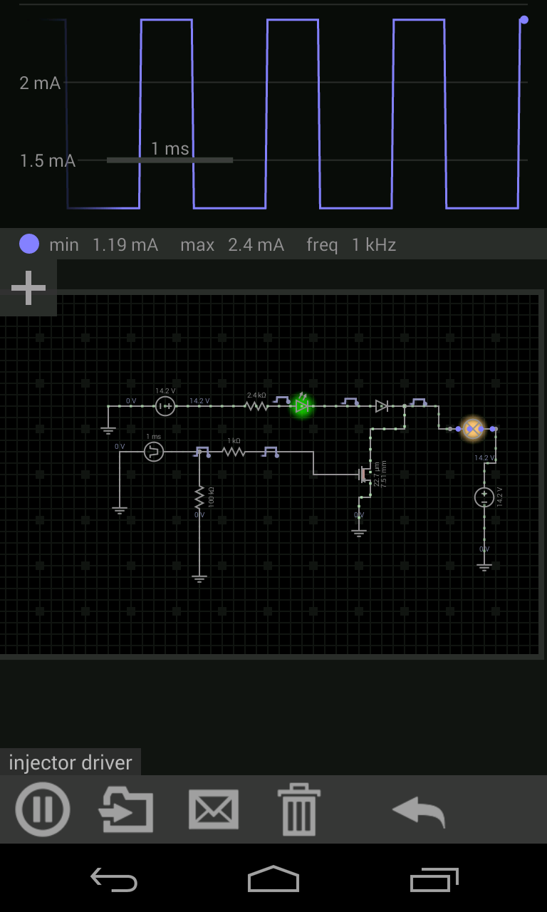

ehehe, a little rough simulation of the injector circuit, for better understanding :)

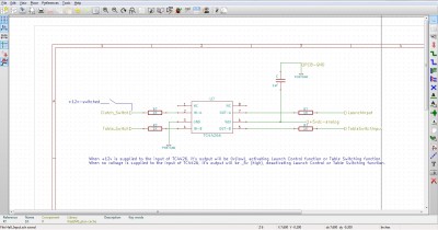

Active high circuit for activating launch control and table switching functions:
