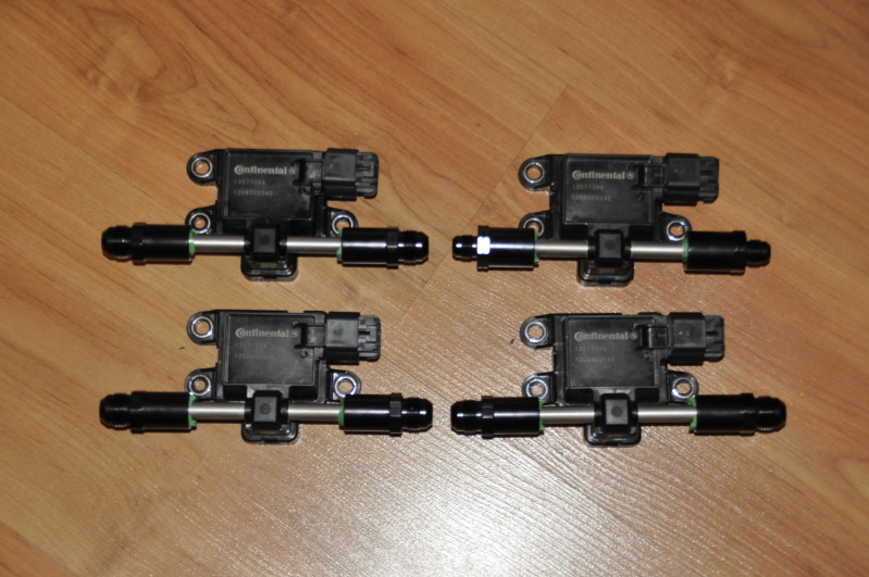

I've a question about fuelling. In my country (Galicia) we only have one place were to get E85 (is in Santiago de Compostela). So I can't use it a lot. I only use it on days I know I will use very hard my car. So I have to enrich the mix around 30% and increase crank PW. The problem are the next fuellings when mixing E85 and regular 98 octane petrol. Do you think with FreeEMS we can use a sensor like saab uses to detect the ethanol percentage and automatically correct fuel and ignition?
If it was easier to change config between 98 octane and E85 (and mixings) I'd lik to use it more.
The problem is that I think those sensors are very expensive. for example:
http://www.ebay.com/itm/New-GM-OEM-Fuel ... 1130124550
Sierra XR4i 2.0T
johu
Posts: 57
Joined: Sat Aug 16, 2008 4:39 pm
Location: Se oli ainakin näiiiiiin iso!
Re: GZ Board
Post by johu »
There's cheaper sensors on market. Claimed to be electrically identical to old GM sensor you linked.
http://www.ebay.ie/itm/281066102838
&quot;new style&quot; sensor
"new style" sensor
&quot;old style&quot; sensor
"old style" sensor
AiToR51
Posts: 80
Joined: Sun Aug 21, 2011 6:26 pm
Location: Spain
Re: GZ Board
Post by AiToR51 »
johu wrote:There's cheaper sensors on market. Claimed to be electrically identical to old GM sensor you linked.
That sensor could be affordable, thanks for the info. ;)

AiToR51 wrote:That sensor could be affordable, thanks for the info. ;)
It's also used by VAG so you might be able to source it locally. Try searching A2C53344228 or 06H907811A.
VOLKSWAGEN 06H907811A IS USED IN THE CATALOGUES:
  • VOLKSWAGEN / ARGENTINA / PASSAT/4MOTION [PA] / 2011 [3C-B-200 001 >>] / ELECTRICS / 90600. IMPULSE SENDER; SENSOR FOR ETHANOL; CONCENTRATION
    VOLKSWAGEN / ARGENTINA / PASSAT/4MOTION [PA] / 2012 / ELECTRICS / 90600. IMPULSE SENDER; SENSOR FOR ETHANOL; CONCENTRATION
    VOLKSWAGEN / ARGENTINA / PASSAT/4MOTION [PA] / 2013 / ELECTRICS / 90600. IMPULSE SENDER; SENSOR FOR ETHANOL; CONCENTRATION
    VOLKSWAGEN / EUROPE / PASSAT/4MOTION/SANTANA [PA] / 2011 [3C-B-200 001 >>] / ELECTRICS / 90600. IMPULSE SENDER; SENSOR FOR ETHANOL; CONCENTRATION
    VOLKSWAGEN / EUROPE / PASSAT/4MOTION/SANTANA [PA] / 2012 / ELECTRICS / 90600. IMPULSE SENDER; SENSOR FOR ETHANOL; CONCENTRATION
    VOLKSWAGEN / EUROPE / PASSAT/4MOTION/SANTANA [PA] / 2013 [3C-D-000 001 >>] / ELECTRICS / 90600. IMPULSE SENDER; SENSOR FOR ETHANOL; CONCENTRATION
    VOLKSWAGEN / SOUTH AFRICA / PASSAT/VARIANT/4MOTION [PA] / 2011 [3C-B-200 001 >>] / ELECTRICS / 90600. IMPULSE SENDER; SENSOR FOR ETHANOL; CONCENTRATION
    VOLKSWAGEN / SOUTH AFRICA / PASSAT/VARIANT/4MOTION [PA] / 2012 [3C-B-200 001 >>] / ELECTRICS / 90600. IMPULSE SENDER; SENSOR FOR ETHANOL; CONCENTRATION
    VOLKSWAGEN / SOUTH AFRICA / PASSAT/VARIANT/4MOTION [PA] / 2013 [3C-B-200 001 >>] / ELECTRICS / 90600. IMPULSE SENDER; SENSOR FOR ETHANOL; CONCENTRATION
    VOLKSWAGEN / BRAZIL / PASSAT/VARIANT [PA] / 2011 [3C-B-200 001 >>] / ELECTRICS / 90600. IMPULSE SENDER; SENSOR FOR ETHANOL; CONCENTRATION
    VOLKSWAGEN / BRAZIL / PASSAT/VARIANT [PA] / 2012 / ELECTRICS / 90600. IMPULSE SENDER; SENSOR FOR ETHANOL; CONCENTRATION
    VOLKSWAGEN / BRAZIL / PASSAT/VARIANT [PA] / 2013 / ELECTRICS / 90600. IMPULSE SENDER; SENSOR FOR ETHANOL; CONCENTRATION
