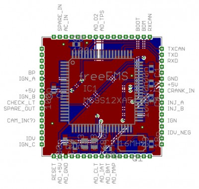

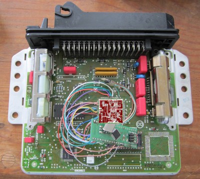

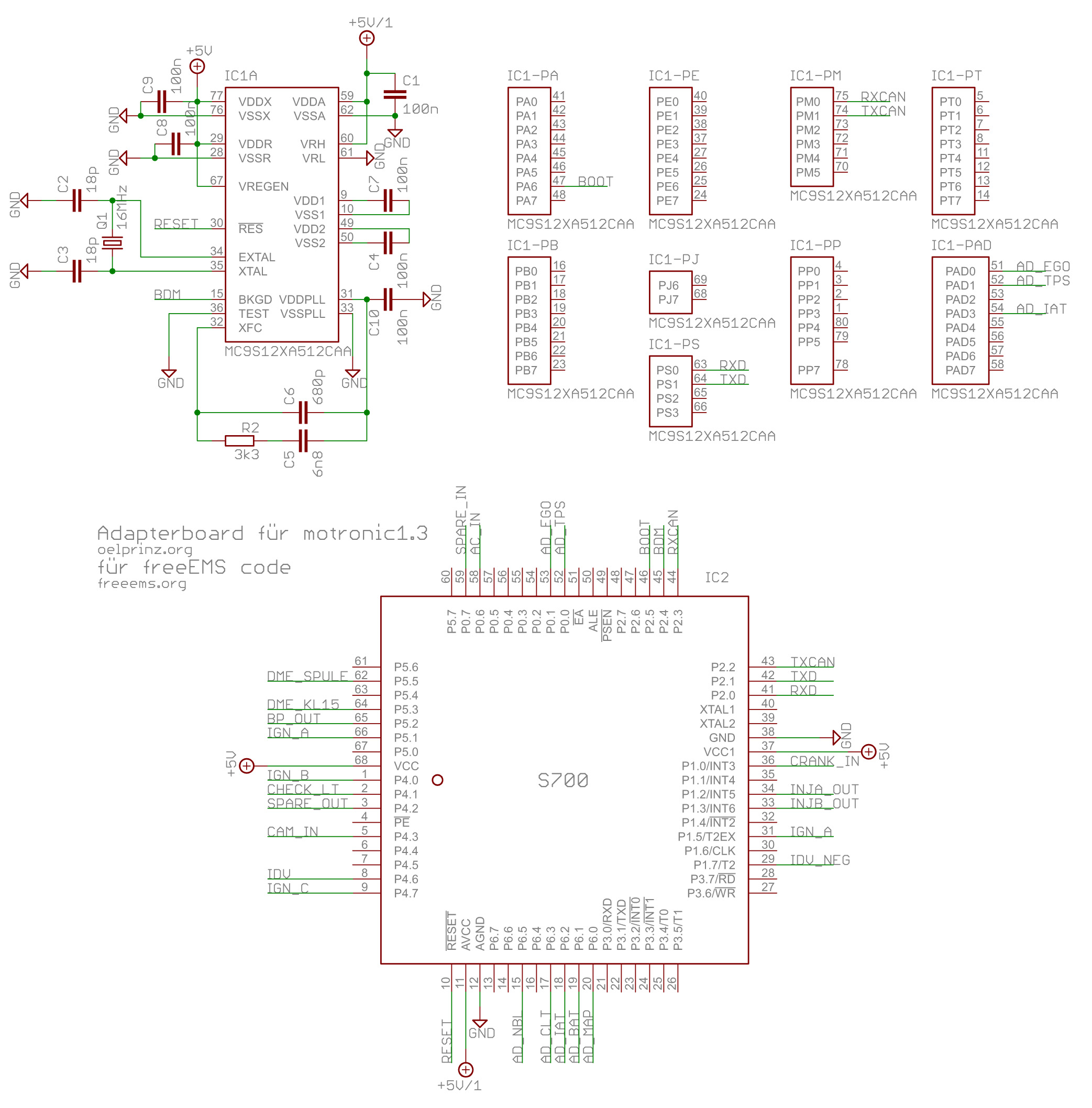

hi,
i hacked a motronic with ms2code and mc9s12 prozessor
it works but i would do it with an MC9S12XA512 and freeems code
i cant found all the pins i need and i hope you can help me
a not complete schematic of the motronic 1.3 you can find here
http://www.e34.de/tips_tricks/motronic/m1_3.pdf

Re: hack a motronic 1.3
EG:Fred wrote:Can you list, in (English) words, not acronyms, nor Bosch-specific terms, the full complement of functions that you require?
2 injector driver outputs
1 coil driver outputs
1 fuel pump relay
2 output for 3wire stepper
3 (spare output)
coolant temp sensor
intake airflow temp sensor
map
tps
battery voltage
crank in (5v logig level)
cam in (5v logig level)
thats the point there is not enough place to did thisFred wrote:Be warned, FreeEMS does not have, and will not have, selectable polarity for coil or injector driver outputs. Logic one/high/5V is dwell/inject. If you need something else, you need to physically invert it on the little board,...
and this 6xbosch-driver need a lowlevel to activ
okFred wrote:Once you list it all, I can help you.
did it
thank you
