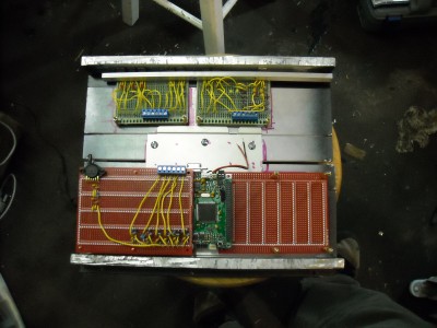

here are some of the first pictures of my TA card setup. I will be replacing the base TA card adapter board with a board like the sensor board. These boards can be stacked!

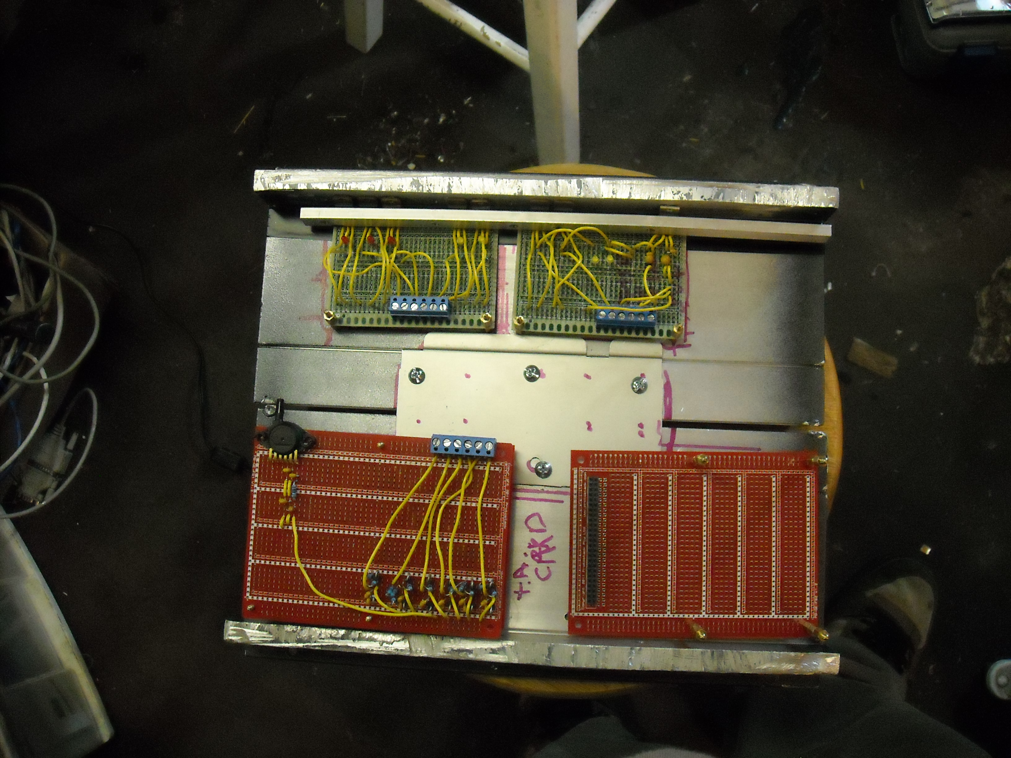

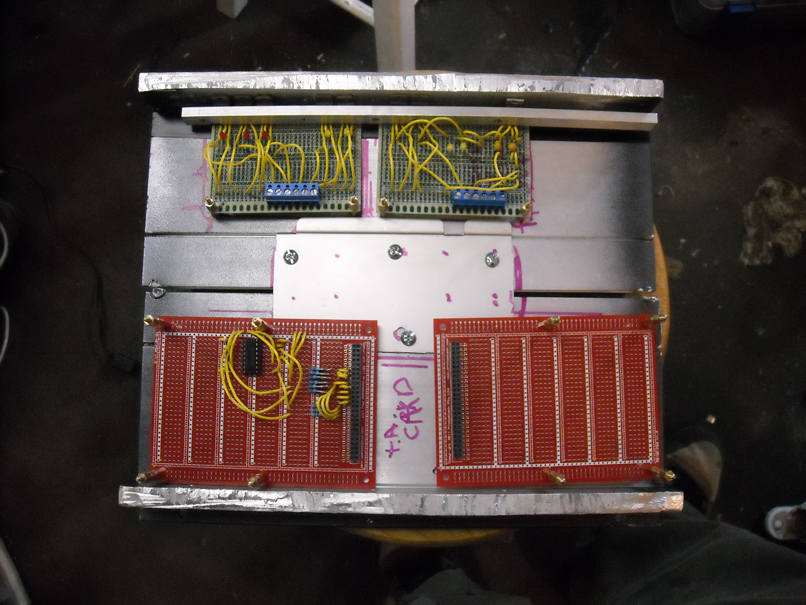

Re: Preludelinux TA card build BMW M52B28
Well here is some mock-up pictures of my monster build!
How many boards can i use ! ?
how big can it get ! ?
But, but, but, all of the boards are empty! lol :-)
I look forward to you getting it to run on that!

Empty is good that means i can add more later.But, but, but, all of the boards are empty! lol![]()
Trying a very modular approach.
- might have 3 more boards
ignitor board and case with sep ground
slc oem board and case
of course I have the tiny max board
- 3x for injectors (2 on each)
1x fan ( need to complete ecu side )
1x fuel pump (need to complete complete ecu side )
2x for 3 wire IAC (no thought of cpu side and to be done after car is running )
1x reg for power supply
