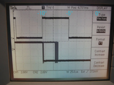

My setup is a 36-1, with 5* nulls and 5* teeth, I've bypassed everything and am feeding right into the (isolated) PT0 pin. The scope is triggering right off the sync line of the fgen .. I generated it on my Agilent 33250 arbitrary func gen:
so my first simple experiment was to have a spark event happen at the same moment at a crank edge arriving:
as you can see, its sort of a bimodal distribution (this is about 4s worth of persistance) .. sometimes it hits right on the edge as expected, otherwise it defers the edge for another 45us (this time is fixed regardless of rpm). So as you can see thats about 2.5* @ 10krpm above.

It's great that you did the tests, it doesn't look like you overlooked anything. Tested both spark channels and everything. I just don't understand the edge trigger scheme.EssEss wrote:My setup is a 36-1, with 5* nulls and 5* teeth, I've bypassed everything and am feeding right into the (isolated) PT0 pin. The scope is triggering right off the sync line of the fgen
Looks like the 2.5° error is measured from the rising edge of the crank signal just prior. Am I reading that right?

that rising edge on the top trace is exactly 10* btdc, it's width is 5*. the bottom trace is the firing edge.
so as you're moving the firing edge right , you're getting closer to TDC (which is the next rising edge immediately off to the right side), so halfway through that tooth width is 2.5* - 10(my ref edge) == 7.5* 'measured advance'
the top trace is 'locked in' and fixed .. I'm looking at the spark edge relative to that.

I see now. In your first image (edited below), the MS is set for 10 degrees advance. And in the second and third images the MS is set for 9 and 11 respectively.

by ref, I meant target .. my target is exactly the edge you labeled. you did it perfectly. what more could I learn from triggering off of the spark edge ?
