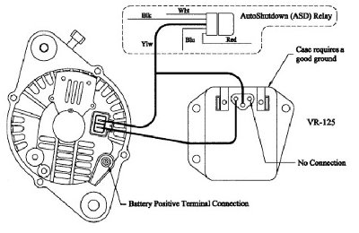

Post by johu »
Nothing to do with Miata, but here's diagram how Dodge Neon alternator needs to be wired to use it without stock computer. Same applies to all Chryslers using PCM controlled alternator. VR-125 is old style voltage regulator used on nearly all Chrysler Corp. vehicles between 1970 and 1992. This is same setup that I'll use on my own project since mounting old style alternator to new style engine would be extra work with no benefits. Some companies try to sell you one wire alternator with built-in regulator for $599... All you really need to use stock Nippon Denso unit is voltage regulator (Standard Motor Products VR125) and required connector (Standard S573), total $37.07 + shipping from Rockauto. Alternator side 2 pin connector seems to be difficult to find but it should be same on all mid 90's and up Chryslers so I'll get one from junkyard.
Image is from neos.org forum.

Good idea:
http://abefm.smugmug.com/gallery/409354 ... 5867_8rQvb
I spent ~$27 on my set up, which is the same thing. You should be able to get it locally instead of from Rock.
I'm hoping the little circuit I'm using (which I'll share if it pans out) will do the same thing, only better. Plus, perhaps the FreeEMS could run it, things like "oh shit idle save"... It's only, um, 4 or 5 cm^2 of board space and $5 in parts.

8InchesFlacid wrote:I spent ~$27 on my set up, which is the same thing. You should be able to get it locally instead of from Rock.
VR price would have been 35 euros (48 USD) locally and VR connector was not available at all. Shipping can take easily week from local shop. I'm still waiting for one small box that was shipped seven days ago from 250 miles away. Package from Rockauto took only 38 hours from time I hit "order" button to arrive on my door. Not bad considering it travelled well over 5000 miles and also spent some of that time in local customs waiting for papers to be filled by Fedex.
I'll need to check what charging voltage I get with same setup using Mopar/ND alternator to find out if same problem you're experiencing is present.
