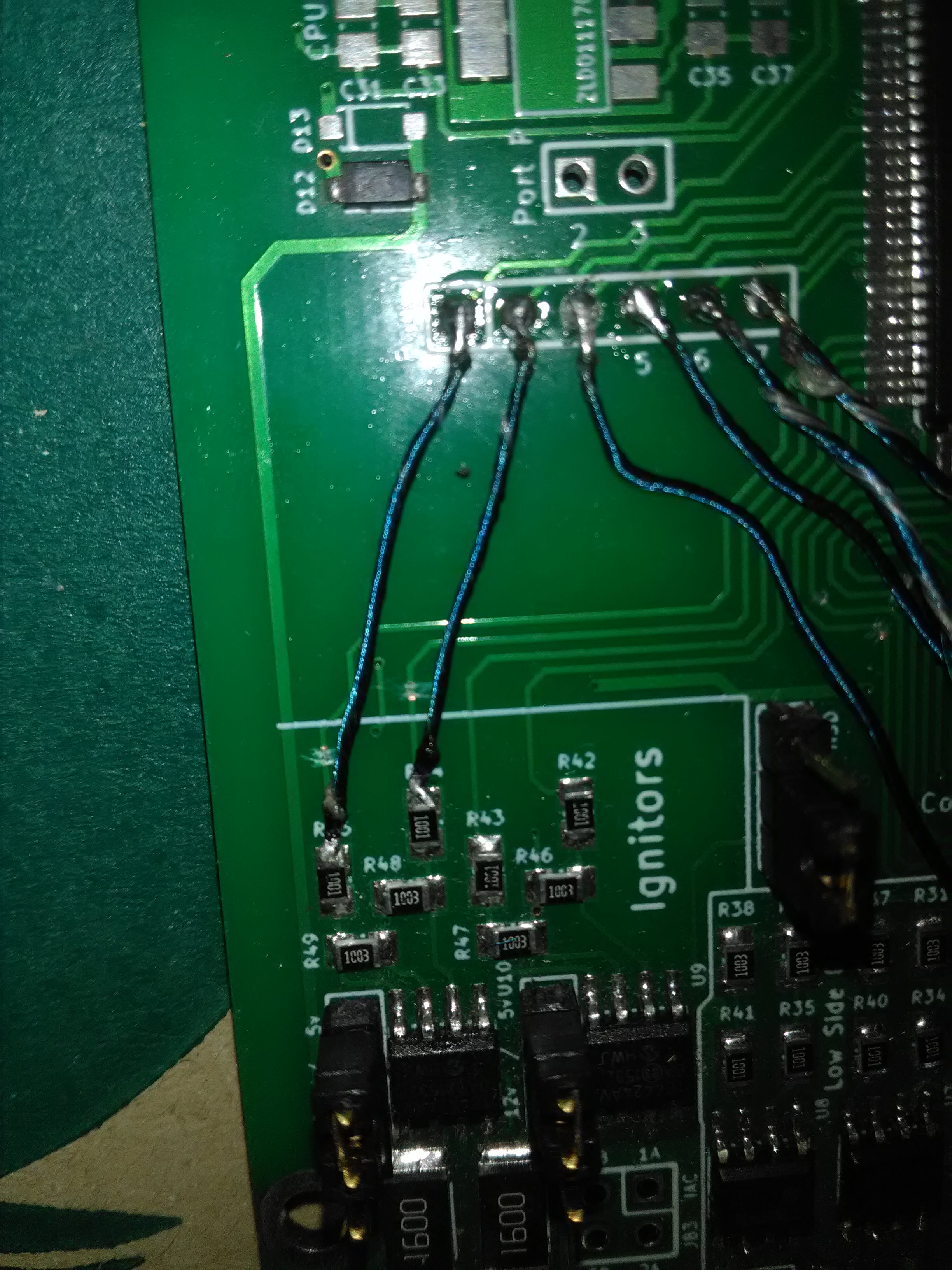

Anyway, I done a cut n jump wire :D
Here it is:-

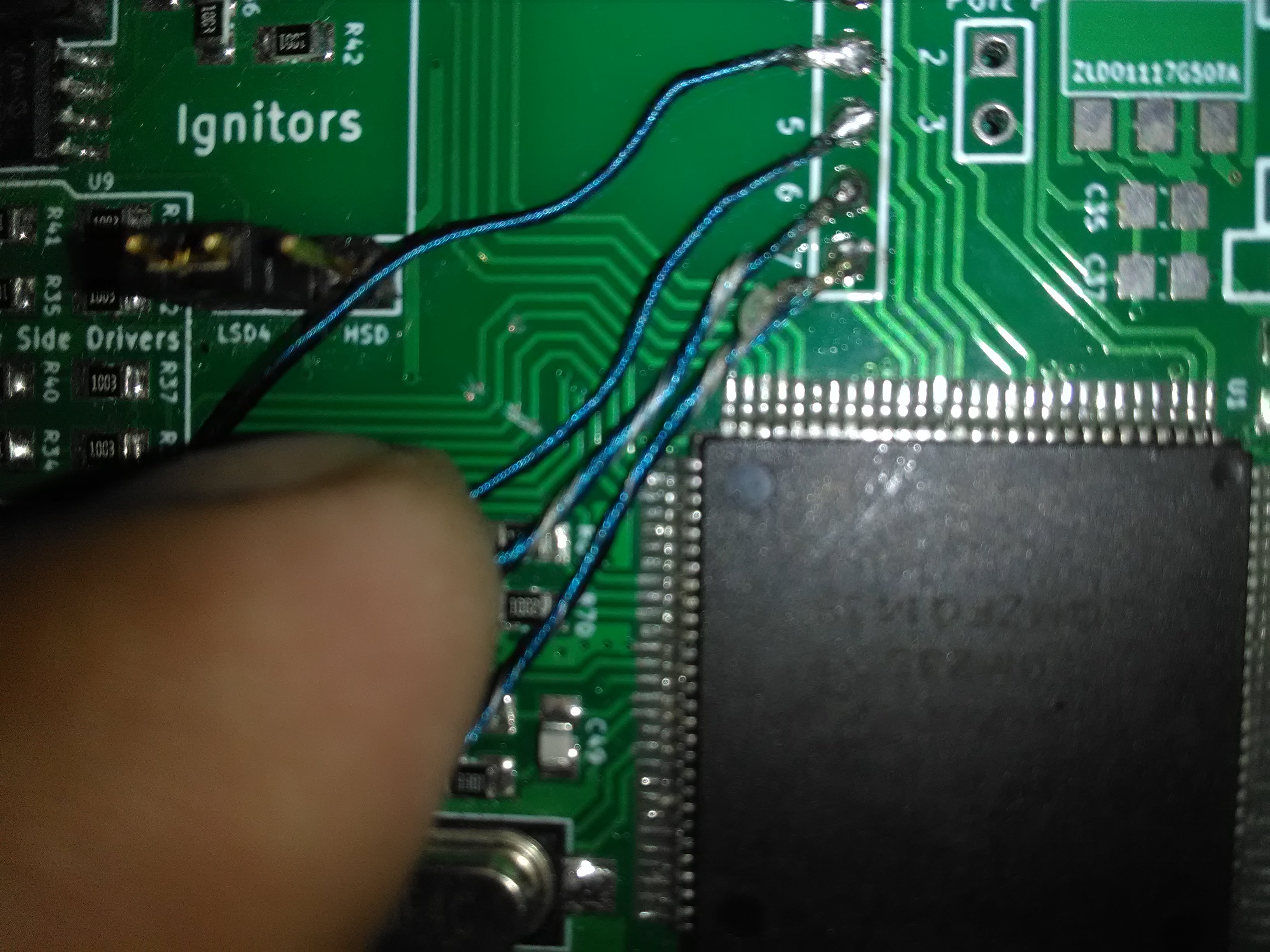

Here is the cut:
Tue Aug 13, 2019 3:02 pm
