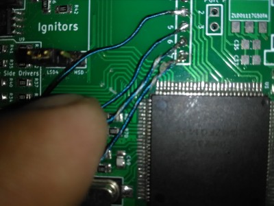

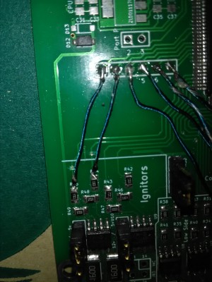

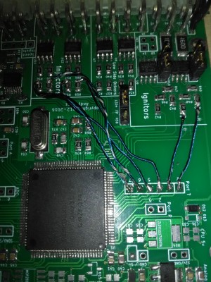

Anyway, I done a cut n jump wire :D
Here it is:-
Here is the cut:
