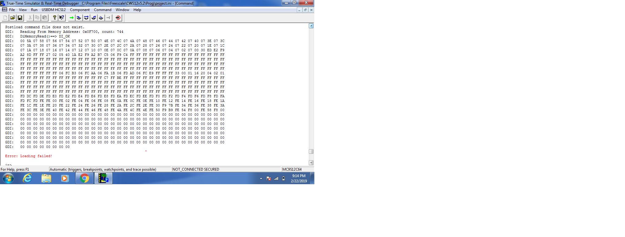

I am doing try and error thing just now. What those error mean? Why below is write not_connected secured?
I just wanna know that code is has been written or not.
Thanks.
amatt

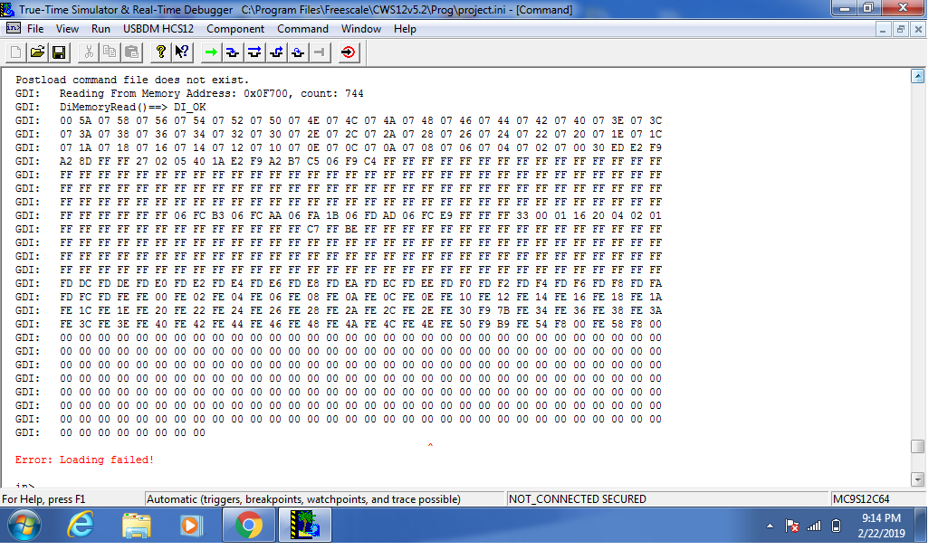

sorry.. picture too small.
here's the bigger one.

No idea, sorry. Never used that tool myself before.

Ok, look like successful with that SM I download from TBrick.com.
