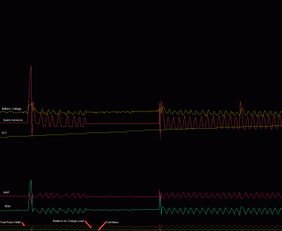

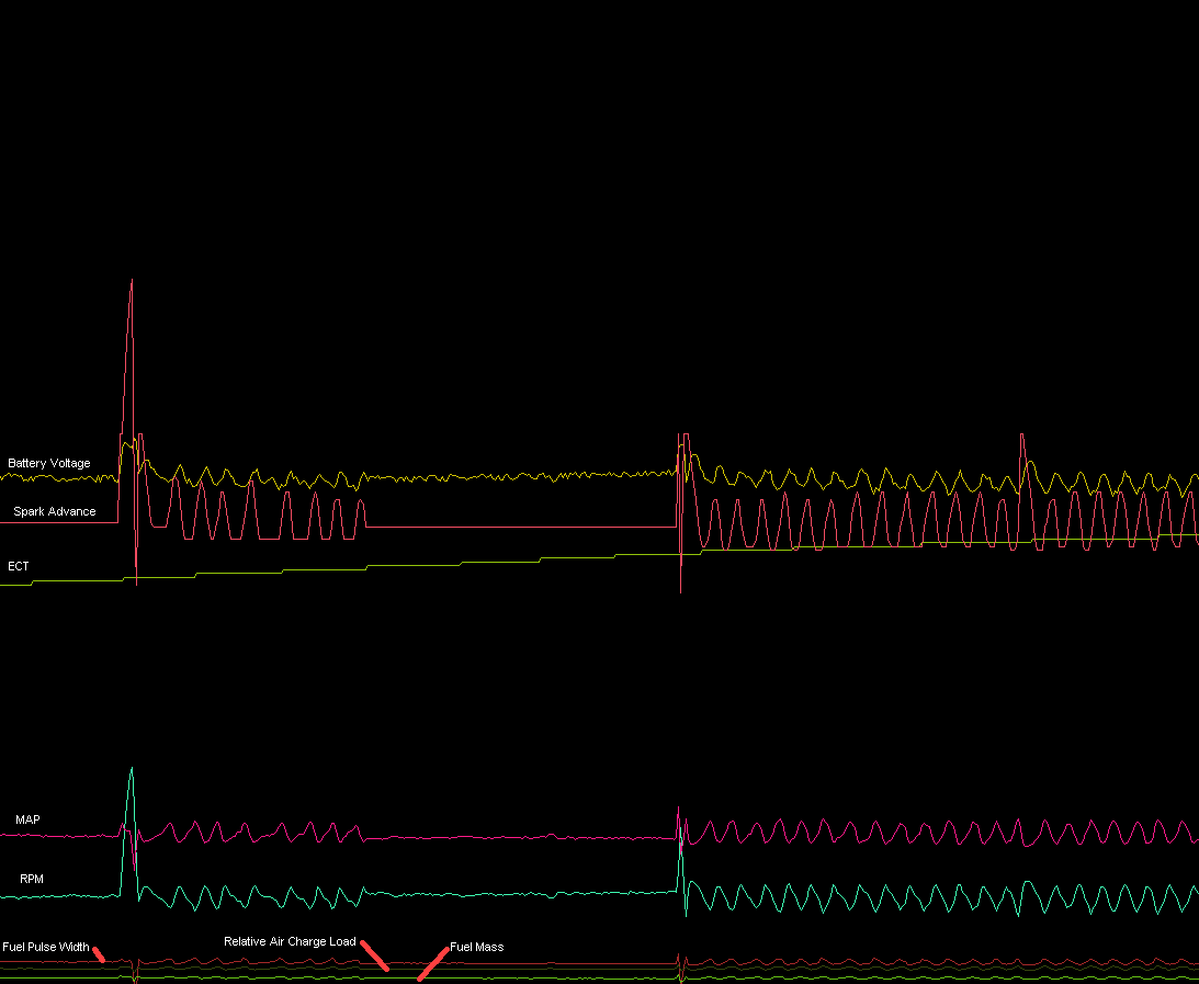

As far as the AFR curves, I'm going to attach a screen cap of a log file. Hopefully it will come through. Ironically, I just noticed that the battery voltage is fluctuating with the idle. And I did read somewhere in his specs that he alters the advance with the battery voltage. Maybe that has something to do with it. I may try a little experiment with a battery charger and see if it makes a difference. But even still, after a ride at high RPM, the battery should be charged. The problem seems worse after I ride it a while and then come to a stop - such as a red light.
