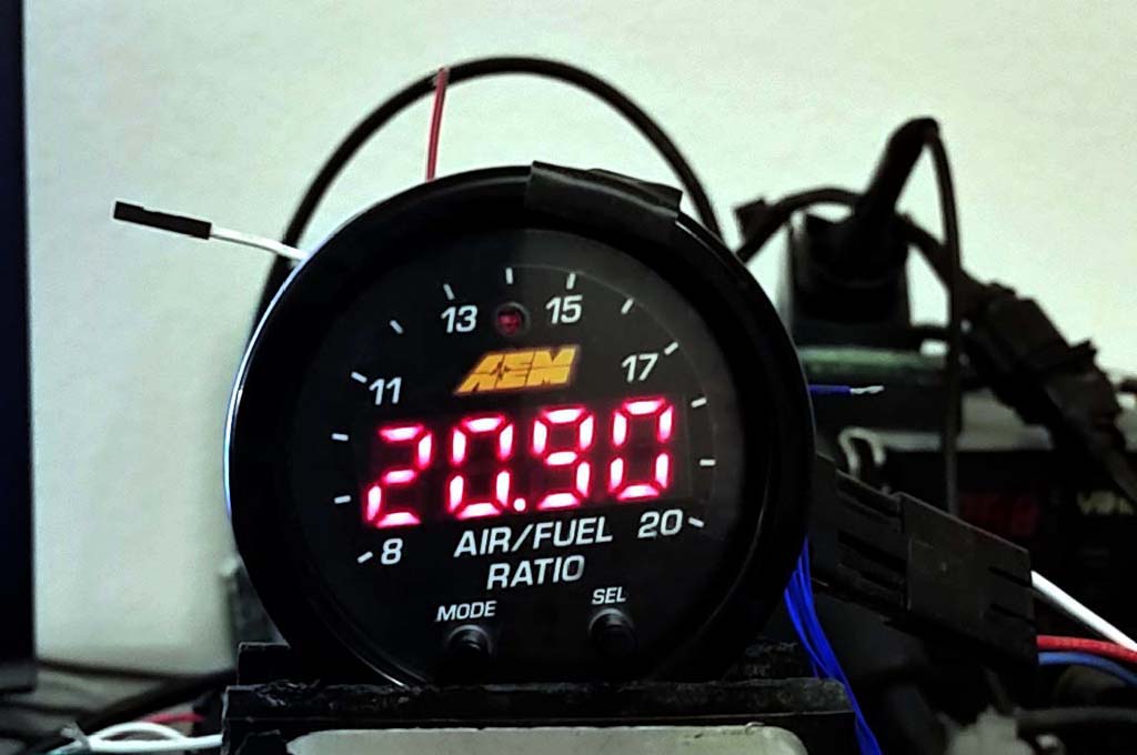

AEM showed a new "X-series" wideband ( sounds like a cheesey 1950s SciFi name ). Based on some new "patent-pending design" that is, either in addition to, or, instead of the Bosch CJ1xx chip. They now claim the fastest response times, according to "independent testing". I do know that it has CANBus output. It is also very thin. About the same thickness as the PLX DM6 gauge. But, the wideband controller is built-in, rather than an external module.

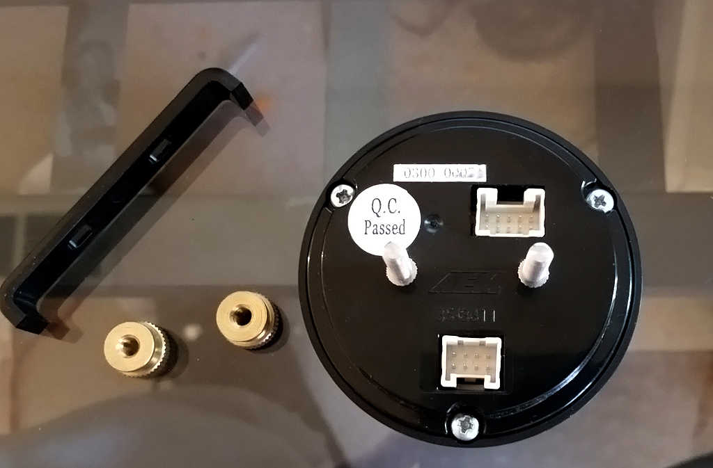

Got one ( AEM 30-0300 "X-Series" )
So far, so good.

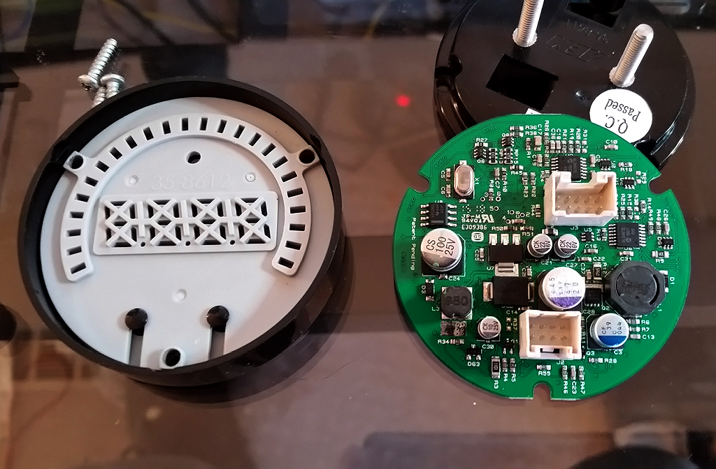

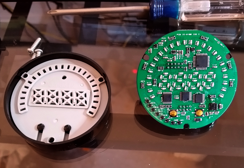

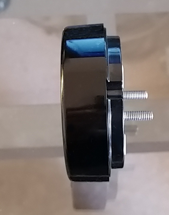

The display and controller are on the same PCB. ( why it is so thin )
There is no Bosch CJ1xx chip
The CPU is an Atmel ATMEGA16M1 ( hard to read )
The big octagonal inductor is for the heater. It is DC-DC driven
The small inductor is for a switching regulator ( probably for the display LEDs )
There is a separate linear regulator ( probably for analog stuff )
There is a sprinkling of TVS diodes and PTC fuses.
The DAC output is pretty clean with the sensor in straight CO2.
The CAN output sends at a 100 packets per second rate. Not decoded yet.
There is some flux on one chip. ( Probably reworked )
Not a fan of the way it screws together.
