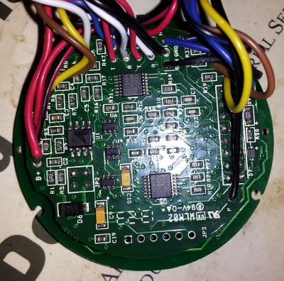

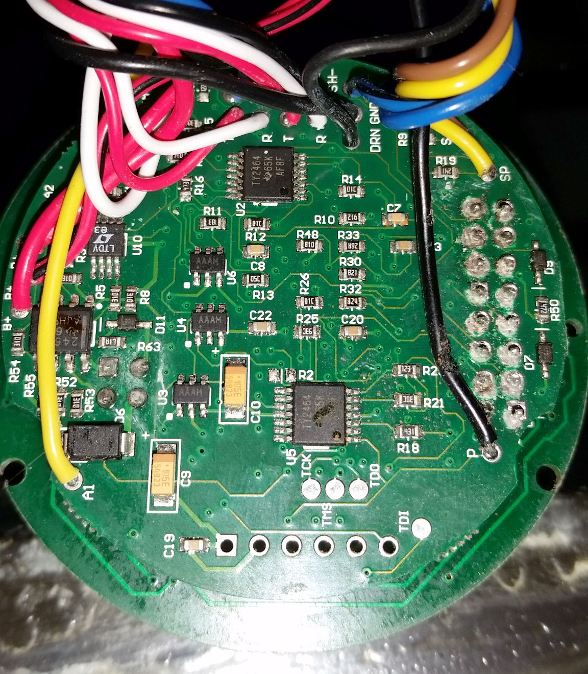

Finally got hold of the new Innovate MTX-L PLUS. A bit strange.
The hardware is ALMOST identical to the regular MTX-L The only visible difference is that they added a proper DAC, to replace the old PWM DAC in the previous design. It's a bit weird, as they used a 2-channel DAC ( LTC1661C ). But, the new gauge has only a single DAC output. Externally, the second analog output wire has been re-purposed as a headlight/dimmer sense line. They have an OPAMP buffering the output. But, for whatever reason, they did not make the output differential. In spite of ground/voltage offset issues.
As for response speed, it's a bit of an oddball. If you catch it at just the right time, it can have a quick response, in the 25ms range. But, more often, it has a strange pattern, where, it make an initial move towards the right value. Then, it kinda tapers in the right direction for a few ms. Then, it "snaps" to the final value. Usually over a period of about 40ms or so. I'll try to get some traces. It does seem to update the DAC at about a 3ms interval. But, there appears to be some kind of buffering of the data. So, you are not getting "new data" every 3 ms.
It is definitely faster than the regular MTX-L. But, it doesn't, consistently, give the faster responses. Maybe one out of 4 is fast. But, even the "strange" responses are 2X faster than the older units. So, it's a real improvement.

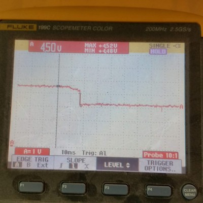

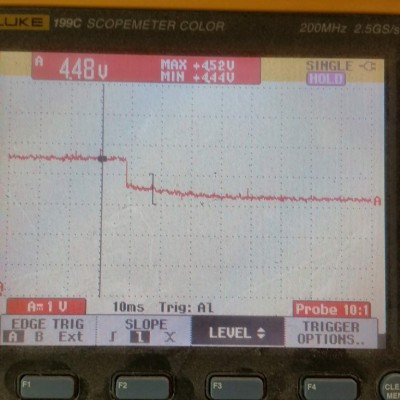

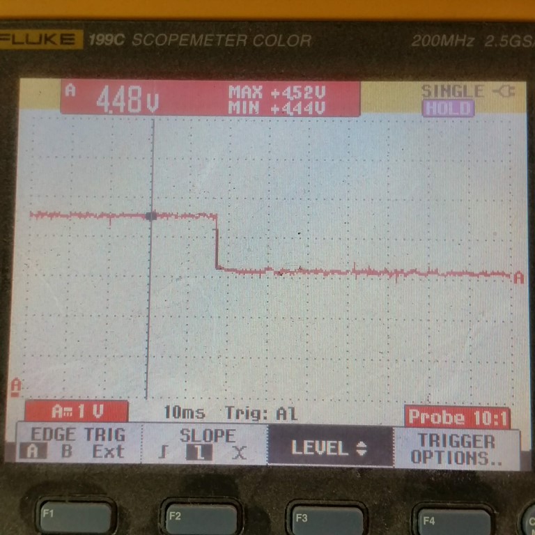

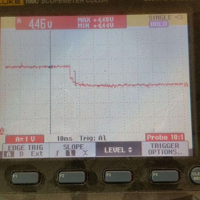

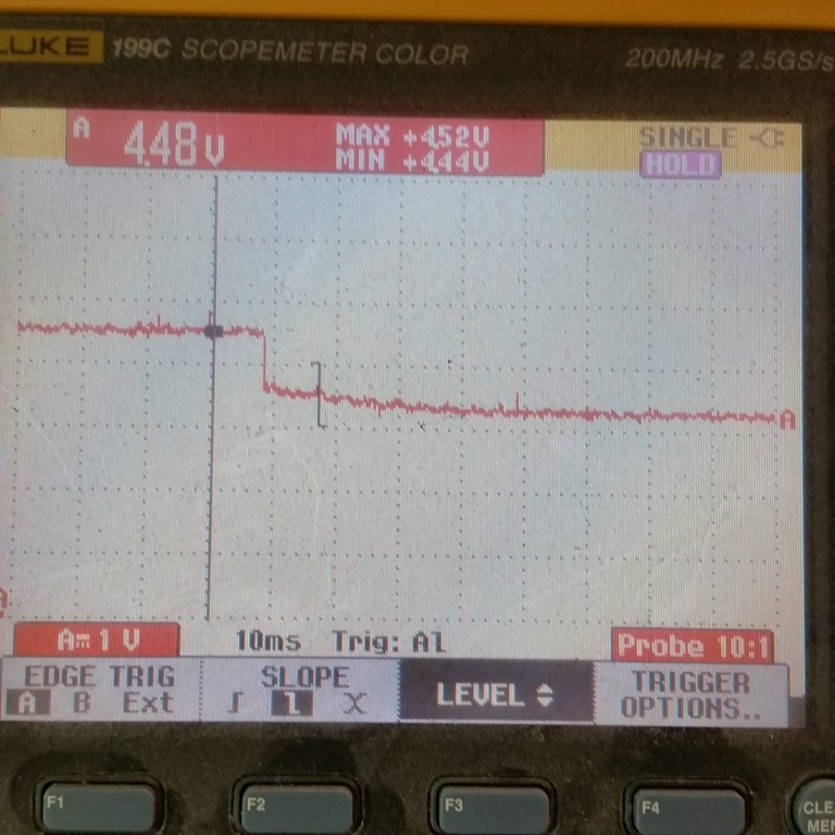

Here's what I mean about the output. 1st, it's pretty glitchy/noisy. So, its hard to get a clean trigger.
These pics are several traces from the same repeated lean-to-stoich events.
The best trace that I got looks pretty good. It was at about 25ms, overall. i.e. the big change happens about 25ms after the actual solenoid firing. I got traces like this about 1/4 or 1/5 of the time.
The other traces show combinations of tapering/ snapping to a fixed value. Usually, over about 40-60ms There seems to be some kind of filtering algorithm that looks at the last few internal samples, and, decides what to output on the DAC. It seems to miss the kind of detail that the LC-1 "instant mode" had. But, it doesn't have the "jitters" like the LC-1.
I re-verified the setup using the AEM 30-0300 and got consistent results in he 20ms range, as before. So, all was good, there.
Conclusions:
Strange. But, in the end, about twice as fast as the regular MTX-L ( 82ms + ) . Maybe even 3X as fast, depending on how you count. So, definitely, a step in the right direction. Would recommend, over the regular MTX-L, unless you need both analog outputs. The higher pump frequency SHOULD give some advantage in heater control. So, MAYBE the sensors will last longer.

How weird! Gotta be dodgy software behind that behaviour... as usual, thanks for posting up! :-)

Interesting. What are you sweeping to/from on your gasses / AFR values? Sorry if this was covered before, will be nice to list test constraints & conditions near the post though on such a long thread.

It probably is a firmware thing. It's hard to imagine what physical thing would have those attributes. It LOOKS MAYBE like they are trying to filter out noise, creatively. When they get a clean transition, it looks good, and they just output it to the DAC. But, if they get noisy samples, they, maybe wait until they get enough samples to know where they are, then, snap to the average value. Or, interpolate to it, depending on something?
I figure, that's why it's inconsistent. Or, not.
This way, they can post a new value to the DAC, before waiting for X samples to be averaged together. So, in a test environment, they may show better than they actually are. Which would be sneaky, but, smart. Imagine a test protocol, where, you take 100 traces and average out the best 10. They would look pretty good, then
Like I said; even with the goofy looking traces, this is a large improvement over their standard MTX-L / LC-2. Because of the different responses to the same stimulus, it's hard to put a number on it. But, eyeballing it, I'd call it about 35ms, if you throw out the worst traces. This, compared to their old value of 82ms+ for the MTX-L and LC-2.
35ms would put them up near the top of the AEM speed chart; along with MOTEC, PLX, and the old LC-1.
http://aemelectronics.com/files/info/AE ... _Chart.jpg
Still, about, 15ms behind the X-series. BUT, THIS IS NOT THE EXACT SAME TEST. it's close, though
The gas sweep, here, is from free-air ( 20.8% O2 ) to lambda 1.0 ( CO2 ). It simulates coming out of fuel cutoff. Which is, usually, the nastiest real-world event.
