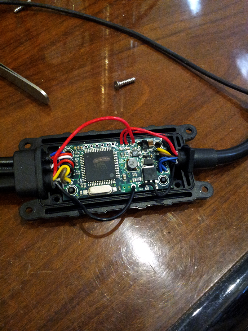

Can you easily open up the LC2 and look at the PCB? if so can you open it up and take a few photos of it and post it up? I wonder if they just took the existing LC1 pcb and stuffed it into a new case and called it an LC2.

Yes. The LC-2 housings are held together with 4 screws. Looking at the PCB ( both sides) , it is almost component-for-component the same as an LC-1. The exceptions seems to be :
1. The 5v regulator is now a switcher. This makes zero sense to me. It adds all kinds of noise. There can't be enough current draw to justify this ?
2. The DAC has been replaced with PWM output ( opamp ). Usually another source of noise.
3. No more individual ground paths. Which, adds, yet more noise.
4. The cal button/LED wire is gone. The LED is now integrated.
I see about 100mv of DAC noise with the sensor in free air. The signal clips at 22AFR ( i think ) So, there should be no measurement noise. That is just the electrical noise from the switcher, the DAC PWM and the heater drive bouncing the one ground line. I bet I would get a cleaner signal using one of the serial line grounds as a DAC reference.

Thanks for the picture.
Did you check the underside of the PCB? I have a strong feeling there is a tonne of components on the underside.
Thanks for the picture, +1 about the other side picture. it'd be nice for the record.
