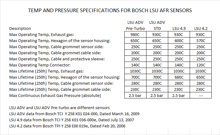

Hentai wrote:I would "suspect" it has to with the point of the ADV, being for pre turbo applications. I've seen one in a oem car. Also I believe the design tolerates higher temps than the 4.9 and 4.2 does. It would surprise me in order to meet the goals it was setup for that was one of the penalties it had to take.
There are 2 distinct versions of the LSU ADV, the normal "LSU ADV" and the "LSU ADV preTurbo" one. They have different part numbers and slightly different specs. Its not safe to assume that all ADV sensors are preTurbo ADV's. And the max allowable back pressure for both the ADV's and the 4.9 is 2.5 bar, so the ADV preTurbo is not rated for any higher pressure capability than the 4.9.
Here are the temp and back pressure specs for the 4.2, 4.9, ADV and ADV preTurbo sensors.

DelSolid
Posts: 59
Joined: Wed Jan 27, 2016 10:41 pm
Location: Los Angeles
Post by DelSolid »
Daemos wrote:I'm actually curious on the data of the LSU 4.9 and LSU 4.9 ADV is the ADV (non pre-turbo) a more robust sensor?
Just to be clear, the ADV is not a 4.9 sensor, its not the 4.9 ADV, its just the ADV. It is not compatible with a controller set up for the 4.9.
The ADV-preTurbo version uses an inconel protection tube where the normal ADV and the 4.9 and the 4.2 do not. That is why the ADV-preTurbo can live in a higher EGT environment. The ceramic appears (at least from the spec sheet) to be identical between the ADV and the ADV-preTurbo. this is why the 250 hour max EGT limit is the same for the ADV and the ADV preTurbo sensors.
When I spoke to our Bosch contact and we discussed the basic ADV he was really surprised we were interested in it and said the only reason anyone should care about it was for the fast light-off time and that was what they considered the big improvement over the 4.9. The OEM's really want this to get cold start emissions under control as fast as possible. If the super high temp limit is a concern then the ADV-preTurbo would be an option.
But, keep this point in mind:
The Bosch 4.2, 4.9 and ADV are all rated for a continuous EGT of 930C, which is ~1,700F.
And all three are also rated for up to 250 hours of 1030C, which is 1,886 F!!!!
Could your engine produce EGT's that high, for that long and survive? do you need the extra temp range?
