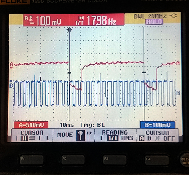

Seems like something is wrong. I went ahead and downloaded the firmware upgrade tool and followed the directions. I tried sever times. But no luck. The program recognized the LC-2 ok. But, no matter what I tried, it would always said that the programming failed, after it finished.
I'll try with an MTX-L later ( when I find it ).
- Posts: 109
Update... the firmware process did work with the MTX-L. I tried again with the LC-2. But, got the same result. Now to try the LSU4.9.
more...
Ok... a mixed bag. The MTX-L will run the LSU4.9 sensor; at least on the bench. I tested it in free air, and, at lambda 0.88 1.00 and 1.22 ( The gasses that I had handy ). The accuracy was pretty decent. It was within about lambda +/- 0.015 ( They only show 3 digits ).
They still have the same problem with the heater. But, it is much less pronounced with the LSU4.9 than it was with the LSU4.2. This is due to the LSU4.9's higher Nernst cell impedance ( 300ohm vs. 80ohm ) at operating temperature. And, a couple of other sensor changes. So that part is good.
The bad part is the measurement cycle time. That is, the rate of lambda measurements. In free air, it is about 18Hz. In the lambda 0.88 gas it got up to almost 40hz. That means that, even if they re-enabled "instant mode", you could only get about 20 samples per second, reliably. Really, only 1/2 of that rate ( Nyquist ) in transition. This works out to about ~12 samples per second. Which matches the serial data rate and the maximum analog output rate. Which, again, is probably not an accident.
Even assuming a mid-point between 18hz and 40hz ( 29Hz = 34ms ) This yields a t63 time of 170ms and a t90 time of 193ms at the 12 samples second data rate.
For comparison, the LC-1 would run at about 120Hz in free air and ~200Hz near lambda 1.0, in "instant mode". t90 was ~16ms-20ms
I would be a bit worried about the heater control in actual use. The LSU4.9 spec requires a heater PID control loop rate of 100Hz or higher to deal with the much lower thermal mass of the LSU4.9 sensor element vs. the LSU4.2 element. The minimum control loop rate for the LSU4.2 was only 2Hz ( Yes... only 2Hz ). The LSU4.9 requires a control loop 50x faster to maintain operating temperature in actual use.
Of course, just sitting on the bench, it will find an equilibrium point and stay there; even at slower control rates.
Since The MTX-L uses the same measurement cycle to measure the sensor temperature, they are only getting 18 to 40 temperature samples per second. Much less than the required rate. This could lead to wide swings in sensor temperature ( and possible damage or premature aging ) before the control loop has a chance to catch up to a hot or cold spike.
For example, decel fuel injector cutoff causes a cold spike and they only get 18 samples/second for heater control in free air.
Maybe it's OK. But, I don't think Bosh would have upped the control loop speed requirement 50X if there was not a reason ?
more...
