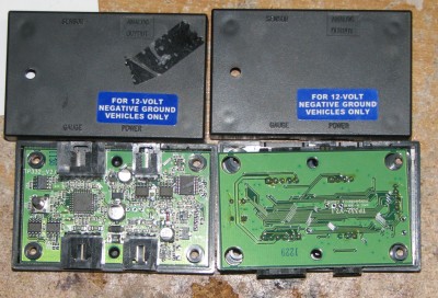

I'm about to put an Aeroforce Technologies wideband O2 kit to use on my truck. The controller's not marked in any way except to indicate which socket is which and that it's made in Taiwan.
Here are some poorly taken photos:
The main chip is, oddly, something called a Toplus TP-6825. There's also a Microchip MCP4821E and some ST chips. This will be reading a Bosch LS17025. The silkscreen on the top left is TP332-V1.0 and E112804 on the top right.
Can't turn up anything interesting online through English searches. Thoughts?

My advice, order a reputable one from Alan (cheap as chips and good as gold), send him this one to test and return to you, and if it comes back with a green light, bang it on the solstice.

I am 95% certain that this is produced by prosport/glowshift (both are the same company). I have 2 of their controllers, it uses the same case, connectors, and button placement as yours. The PCB on mine is different, mine is marked TP332-V2.0.ToxicGumbo wrote:I'm about to put an Aeroforce Technologies wideband O2 kit to use on my truck. The controller's not marked in any way except to indicate which socket is which and that it's made in Taiwan.

Those TP markings are a red herring, they removed the original markings and put on their own markings, no idea why they do stuff like that.
On the controller I have, one of the chips marked TPxxxx is an atmel AVR (IIRC) microcontroller, the other chip marked TPxxx is a bosch CJ125 (could be a CJ110) chip to control the lambda sensor.
On both of the units I have, they both read about 1 AFR richer than lab gas.
There you go, Jeff, save the postage, sell it, and buy something good :-) That "wideband wizard" title I gave you is certainly fitting! :-)
