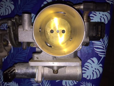

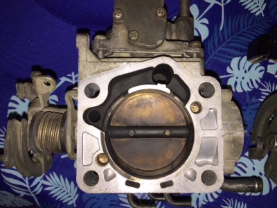

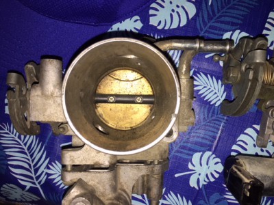

I want an opinion. I don't plan on running high boost, I had the TB bored out and it has worked ok for na, I thinned out the shaft myself- I aslo JB welded everything together- and I'm kind of looking at this sidewise, I have a spare TB should I go back to stock or change out the shaft- for robustness.
