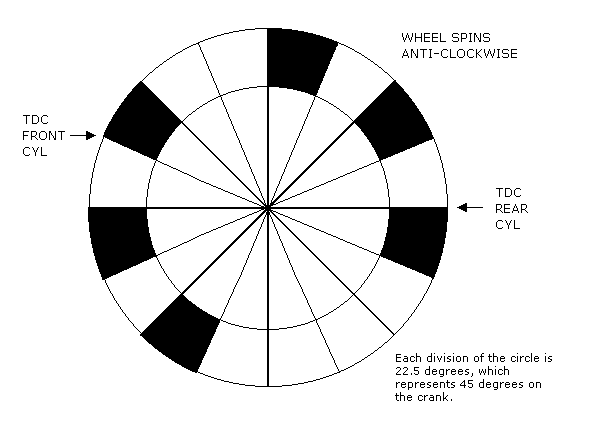

The Buell m/cycle engine 2003 to 2007 has a cam rotor cup (see attachment).
If the wheel is easy to decode, I could start laying out the 3rd mini ecu for this bike. The last one I showed on this forum has been removed. Everything worked fine, but the code cannot read the wheel, but it can read the oddfire tach output from the stock ecm, but to be able to use "dual table" it must sync up, and when reading the tacho output from the stock ecm it takes too long to start the engine, which is understandable as it's only one pulse per crank rev, and they are oddfire, also the beginning of the injection event is not suited. The engine is a 45 degree v-twin, it is like a 2 cyl inline and one cyl is rotated 45 degrees forward. It has a siamese type inlet with one throttle body feeding both cyliinders, and one inj per cyl, the inj's are about 5" apart, so fuel sharing takes place and a fuel table for each inj is required. Not easy to tune, but can be tuned.

Re: Unsupported engine platforms (what is there?)
I can see that being doable I think. I have very little experience with writing code to do that sort of thing, but I think I could make it work. It is definitely a good idea for you to let me get the toyota code working AND reliable first though. I also need to come up with a scheme for keeping track of where we are that will work cleanly for multiple modes of operation. I may start a thread on that at some point, but it's down the list a little right now.
Have you considered hitting up James for some test code for it? That will get you a usable bike a lot sooner than I can finish the FreeEMS code to a decent standard. I know it goes against the point of this thread, but you should definitely look after number 1 first.
Fred, its not urgent, I can use and tune the stock ecu, it works OK, but is difficult to control. I have to chain it down and beat it into submission to get it to do what I want : ) I asked about this wheel now rather than later because if I don't ask there is no possiblity at all : )
I did ask James a while back but space within the wheel decoder and free time were short. You have given me another idea to persue however, I need to do a lot more bench testing... Also at the end of the day I could fit a different wheel and sensor in the 2" diameter space available but that's for another thread.
