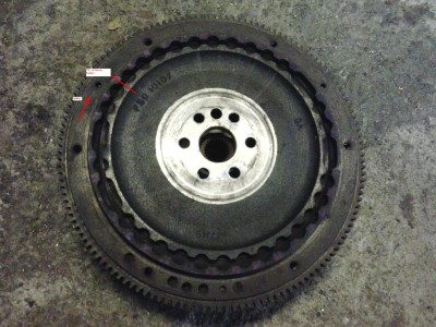

finally i managed to take a pic
tried to mark the rotation and sensor position at TDC cylinder 1.
luckily i'm not in a hurry as i found another engine with a 36-1 trigger i fitted to the crankshaft long ago and if i looked right there is a decoder for this pattern. so i will start with this and switch to the 36-1-1-1-1 when a decoder is available.
seems to be time to describe my project car(s) soon i guess

Good to hear :-) Thanks for uploading that!
