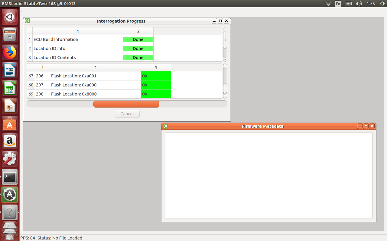

I do some testing just now, 282 and 285 Scavenger s19, still same issue.
It is normal firmware metadata is blank?
This happen when Ardstim set rpm to 1100.
-crank sync never be green
-cam sync, last timestamp valid, last period valid blinking red green red green
-which input was last changing 0,5,2,1
-UId reason changing 2,1,2,1,2,1
-where in the input pattern sync was lost changing 6,3,10
-where the input pattern sync was record changing 4,10,11

Meta data and tracing would depend on matching firmware and EMStudio - chances are you don't have them in sync.
Only the hacked-by-Fred-and-Rob version of EMStudio is worth using, prior to that it was buggy as hell and divergent.
I can't even remember if it's backward compatible with the firmware you've been grabbing, or not.

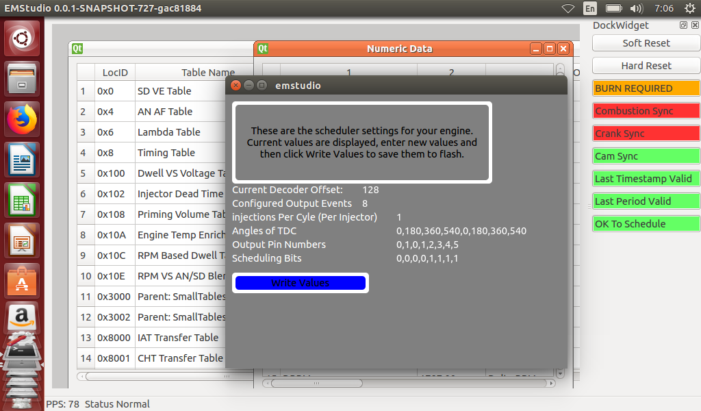

Meanwhile, Movement Control Order extended to another 2 weeks. I looking at the code, and do some edit (Scavenger config) for getting sequence injection/batch ignition.
And the result:-
Few question:
1) What is AN AF Table is?
2) Is it ok TPS close is at !6% opening in Emstudio?
Wed Apr 29, 2020 10:18 am
Posts: 15394
Thread updated :-)
AN = Alpha N
AF = Air Fuel (I think, it's been a while)
TPS = you can configure upper and lower bounds for it - maybe using EMStudio, but not sure if the version you have, or not. Then it'll read correctly and log usefully
If you're turbocharging your engine you probably won't need/want AN AF - it was never fully developed though I have driven a few cars on that code. Speed density is best in most cases.
